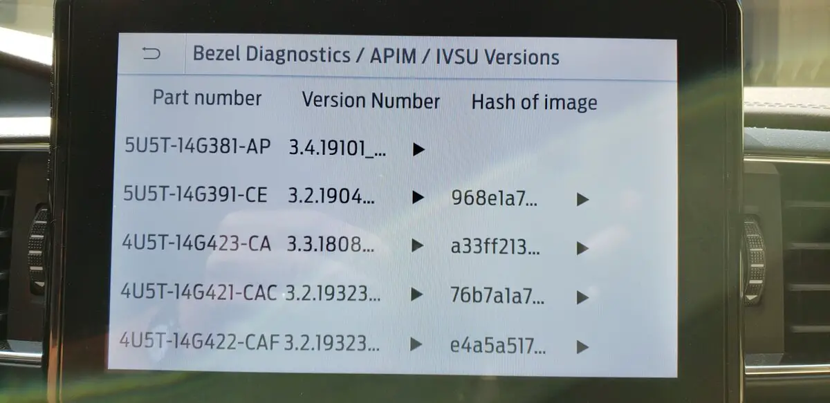

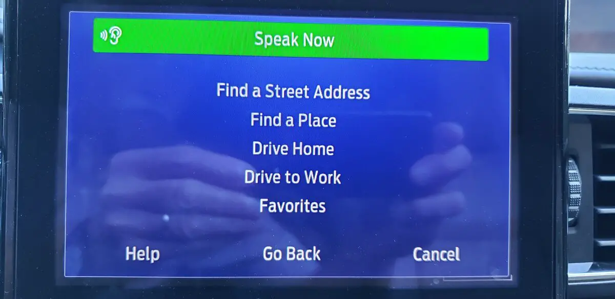

So, it looks like it's there. Do you see any nav command samples in the list that pops when you press the voice button? The only other thing I can think of, that I've only ever seen on a bench, is that something didn't mount properly. You can try a master reset as that could fix it.

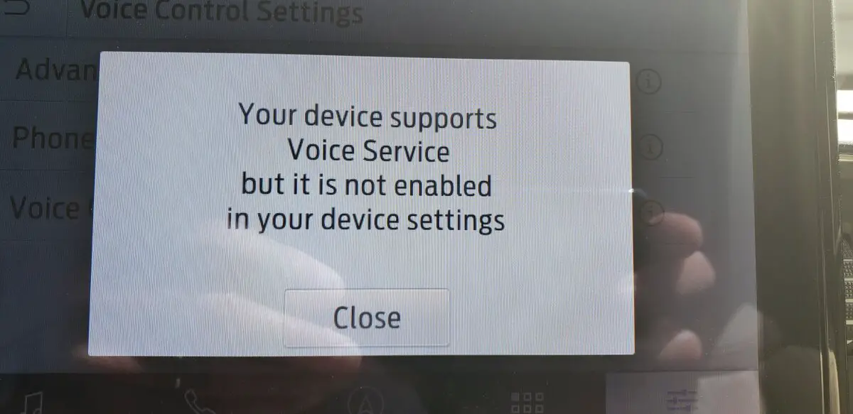

When pressing the voice button a list of options does show up on screen. I also did a master reset before doing your suggested truncated update but that did not help. Would you suggest I ask the dealer to re-install or update the sync software? I was there yesterday and asked if they would update the software, but they said I can do it OTA (which I’m not sure is available, yet) or they would charge me.

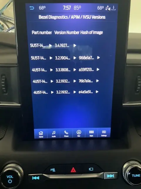

Re software, check out his post here; SYNC 3 .4 Most recent version?

Yeah, you can have them take a look. It appears that everything required is installed, so it doesn't make sense it would abruptly end. The only reason for that to happen is it can't load the nav voice data. That means either it isn't there (which it appears to be), or the image isn't mounted in the file system. But, if you ran the install twice, and it went through all 3 steps, it should be mounted. :banghead:
