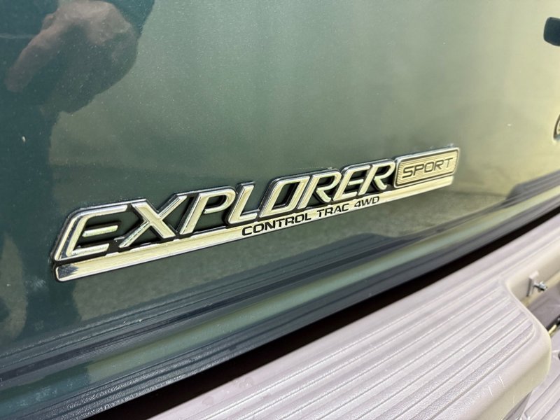

I have a 1996 ford Explorer Sport.
I think there is something wrong with my t-case.
The Selections on my dash are 2WD 4X4 High And 4X4 Low.
If i have the selector in 2wd and but the vehicle in gear and let it roll in the air (wheels not touching the ground). the front driveshaft spins. same thing if the vehicle is on the ground. I'm like 99% sure that the front driveshaft isnt supposed to turn in 2wd. but i keep seeing people say that the BW4405 is an AWD t-case.
I'm just a little confused. Not sure if i have to rebuild my transfer case. Tried Removing the 4wd motor and turning it to 2wd but it didnt do anything.
Any insight is greatly appreciated
-Ninjasupahsquid

Okay so 96 2 door is it control trac awd? Does it say control trac on the back of the truck?
If so your t case is awd
You should also have a cad, center axle disconnect on the front differential, pass side there is a solenoid that locks and unlocks the passenger cv axle
This was 95/96 v6 only
Control trac the front d shaft will spin even with front tires in the air yes
You have a control trac transfer case which is basically full time awd and part time 4hi and 4 low
