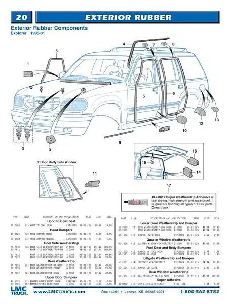

Question: I am looking at the weatherstrip on the LMC Truck site; it appears to be a solid loop. Is this correct?
see item # 5 in the picture.

It should be split at the bottom where the arrow is.
Yes it's one long strip from Ford. I understand about the 2002+ parts, the 90's Town Cars have a cover edge as part of the weatherstrip too. I used that in one of my 95 Crown Vics.
