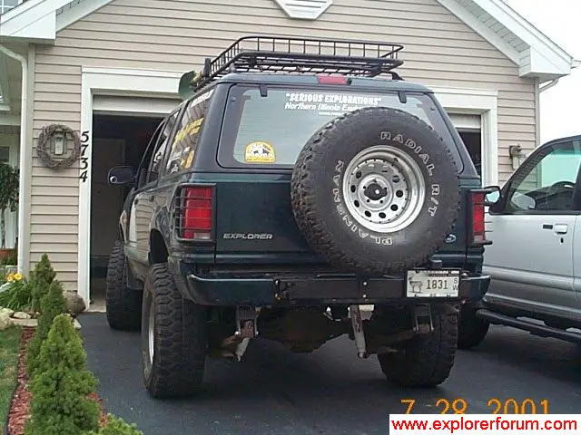

Glad to hear you're getting back into the game... Your X pictured below was a huge reason for getting me off my butt and installing a 4" Skyjacker II lift in my '93 Xlt... What measurements are you looking for?
Oh boy! the Un-Limited has been sold long time ago... I have no clue where it's at right now. It was probably my best "creation" so far.
