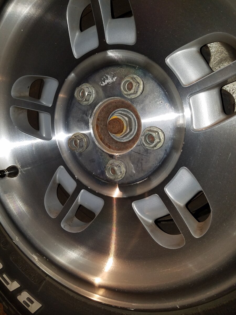

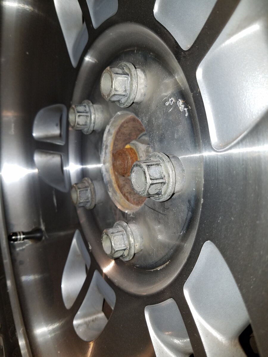

They look right to me...although those are not Explorer wheels. Thy appear to be Ranger wheels.
Someone in here may know if the Ranger wheels are thicker, requiring a longer stud for proper nut engagement?
Thanks. I have to fix this fast. Mechanic swears that it's a huge safety risk driving with these wheels and those lugnuts on them. Even though I've been driving on them for 25 months now, he says it's a huge safety risk and I just can't continue to take any chances. So I'm guessing the cheaper route would be to just get lugnuts that would be better suited for the wheels.
Either that or I buy steelies that will come with it's own lugnuts. But then I would have to pay to have the tires mounted on them and it will be a lot more.
Yeah....I think those are predominately Ranger wheels....that's what my '94 had.....but I have seen a couple pics online with 2nd gens with them....although they might have been added later like apparently his are. My Ranger ones were only 14" rims too.....got rid of those quick....
**And IF your first mechanic actually did replace V.C. gaskets hopefully he used rubber instead of cork....otherwise a re-torque will be useless.
The ones you've seen likely have different lugnuts on them. I will have to visit my lugnut store tomorrow and see what they say. Mechanic says to not drive on these anymore until I get it fixed.

These definitely look to be Ford Ranger wheels. So if I go buy lugnuts for the 96 Ranger then the lugnuts should be different.

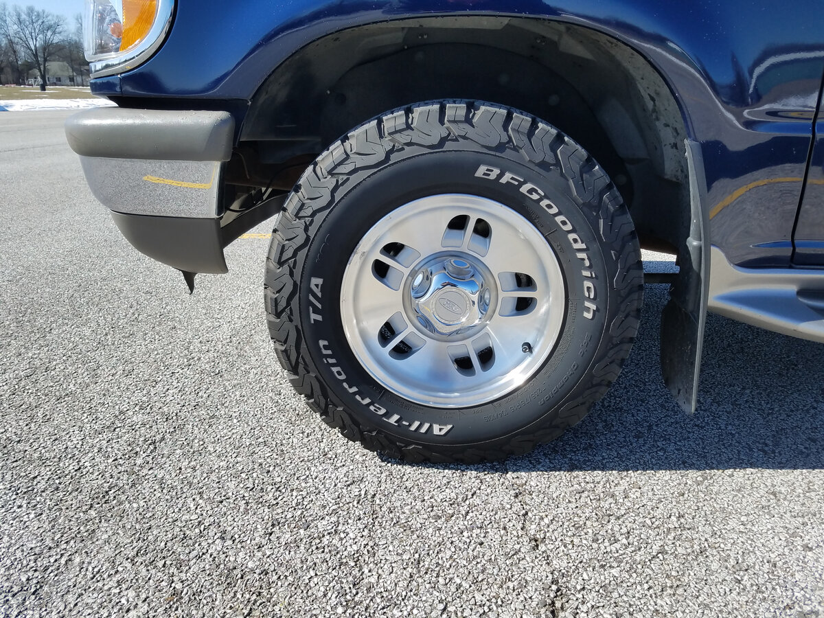

Our '95 4 Door Explorer XLT wheels that came on the truck from the factory.
Without the cap.

Thanks. Very interesting, so it looks like I have explorer rims? Is there a gap between your lugnuts and the wheel? Can't tell in your pic as it may be a reflection too. Looks like there is a gap from the lugnut to the wheel.
Trying to figure out if you and I have the same lugnuts.

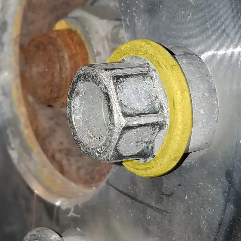

If the highlighted area is what's causing concern, I believe that is there to prevent a socket from contacting the rim during tightening/loosening of the lug-nuts. The contact point of the lug-nut to wheel occurs in the recessed area which is cone-shaped. IIRC
Thanks for the pic. I just finished getting it checked out by two wheel businesses (not tire shops but actual lug nut vendors) and the lugnuts on the truck right now are correct.
We took one out and compared it to the 1/2" ones they had in stock, spun both on the studs and everything was the exact same. The lugnuts on my truck right now easily go 9 full turns, tightened by hand. So not sure how that mechanic came out to the conclusion that I had the wrong lugnuts and driving on it was a huge safety risk. Even though I've been driving on them for 25 months now and no issues. The guys and owner at the shops were completely confused how the mechanic concluded that they are the wrong lug nuts.
