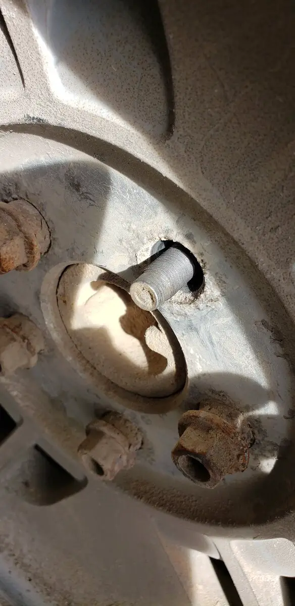

Was told these are the wrong lugnuts for my rims. Does anyone else here use open end nuts here? What's concerning is notice how the nuts don't go all the way so the back is flush to the rim?
I looked into at the store and the shop said you can get closed and open. But what comes from factory?
Thinking this is the correct lugnuts that should be on them.
Those original lug nuts are correct and same as on my '98 XLT. They aren't supposed to tighten up to the shoulder.
Okay thank you, good to hear this. So you have the open end nuts too on your 98? Wonder why on these trucks, design maybe? Good to hear I don't have to buy another part.
When I saw that the lugnuts didn't go very far into the threads, it worried me.
Yep...open end. Who knows why they fit like that...but, you're good to go.
Thanks for the reaffirmation. I was on edge about it but just had to make sure.
Those are the proper original lug nuts. Those have been used on many different Fords.
That shoulder on them is for other wheel types, which had center caps that attached to those shoulder edges. Those are very strong lug nuts. The older Explorers had much smaller lug nuts, about 2/3 the size of these.
Thanks, good to know this. Never seen lug nuts this small especially on a truck.
