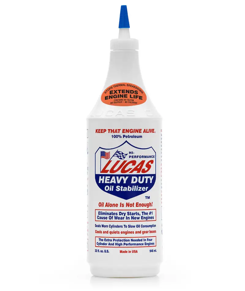

I have Lukas Oil stabilizer too, I may add some of this when my oil level drops just to make the motor oil thicker. Right now it doesn't seem to be leaking very much oil. And I am doing quite a bit of driving on this truck daily and the motor oil isn't losing near as much oil as it was prior to the gasket repairs.
Have any of you guys used this in your explorer? Will it mess up the chemistry of my Castrol high mileage oil?
I mainly want to add it to make my oil a bit thicker. I would only add 1/4 quart to start. I think the whole bottle to a 1:4 Lukas:Oil ratio like the bottle suggests is way too much. Over time with oil changes I would imagine some of this stuff to remain in your motor.

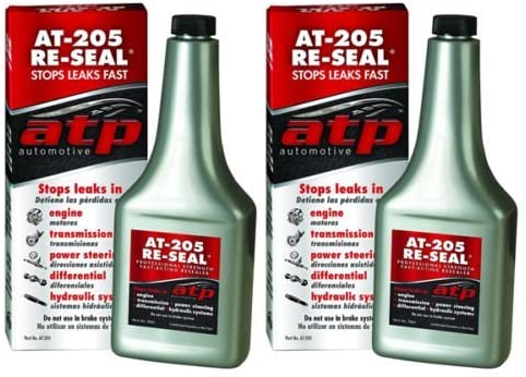

I’m going to preface my post with this: I generally don’t believe in additives. I have a few exceptions like LSD additives, diesel fuel additives, but they’re also typically called for by the manufacturer.
I’ve seen guys use products like K-seal to help a vehicle that would otherwise get junked make it another year or two, or dump a bottle of transmission fix into a half blown trans...but I would be hesitant thickening the lifeblood of an otherwise good running vehicle just to keep the driveway clean.
I know that leaks are annoying. That said, fluids and lubricants are specified to be a particular viscosity for good reason. You may get those leaks to stop by thickening the hell out of your fluids, but you may also damage your motor/PS pump/etc in the process.
Adding what is recommended on the bottle likely won’t hurt, but I absolutely would not exceed that.
That all said, I’d sooner just park over a sheet of cardboard and check the fluid levels weekly than mess with costly additives.
Up until now, I've never put any addictives in any of my cars in my life. I am now a fan of K-seal though, it did wonders. Wish the same existed for motor oil and PS fluid.
I am hesitant to put all of the Lukas oil stabilizer in but the reviews on it are just so good. If I did add it, it would be maybe 250ml per oil change which shouldn't be enough to cause the oil to be too thick in the winters, but enough to add some viscosity to it. The only thing I don't like is that this doesn't have addictives in it, it's pretty much just an oil thickener and it will water down your addictives in your current oil.
