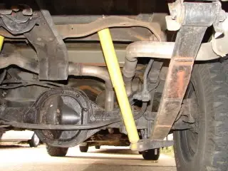

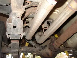

Well just look underneath your ride and see. It has dual exhaust all the way into the muffler. Now what you could do is have some bends made at the rear end and go out to have that dual exhaust look. I think this is from Xan's old mounty
Here is a lil cross-over tube I had put on, but didnt make a huge difference.

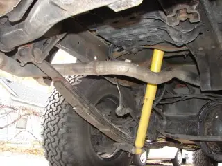

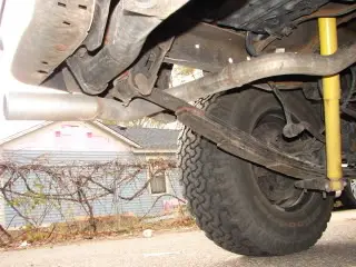

And here is my first setup with dual flows

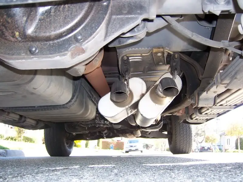

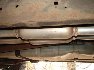

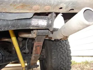

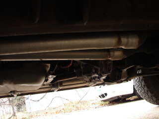

Here are some pics of my dual exhaust that i have on my 01 xlt 5.0 also the 2 rear cats have been removed, i will get a video up as soon as i get gas in my truck some low lifes sucked all the gas out of my truck last night so i started it and ran for about 1 min and ran out of gas lol.
