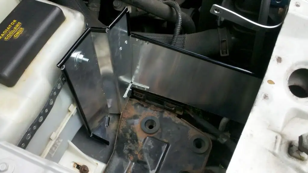

No problems whatsoever with water, solved my breather hose problem with a breather filter. Replaced with black silicone couplers from spectre, then built myself a little heatshield.
Cant say you are over reacting, I wondered the same thing myself. Have not had a problem. rokr, do you have a pic of the heatshield you made? Always looking for ideas.
Nothing fancy.
Nice work! Thanks for the pics-great bends etc. Fit looks perfect.
