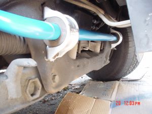

Finally got around to installing my Sway Bars today. I took the time to paint it Ford Blue. Color came out too bright on the picture but it really has a nice darker color to it.

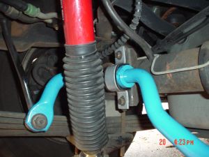

Anyway, I considered just buying the rear bar but I'm glad I didn't. Here's why. I installed the front SB first to see the difference between the hollow stock SB to the solid EE SB. The test drive with the new front bar and with stock rear bar was amazing! I could feel the tire grip the road on turns. A sports-car-like cornering! This alone was enough to convince me of how effective they are and I haven't even installed the rear bar yet.
For those who put off buying the Sway Bars, you have got to catch the next Group Buy!
Picture of the front bar:
The rear:
Nice touch. I had to run to the store, so I also saw what it was like with just the front one changed. I felt the rear slip. Glad I put both on.
looks great! I cant wait for my rear bar to come in.
