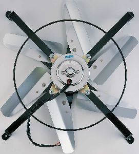

I have this one purchased from jegs.com :

Thank's for all the info. How do they control fan on/off. How about when running the AC in traffic in the summer time?
The fan is automatically controlled via a thermostat ( user adjustable ). Further, there is a full manual control switch. It can be hooked into the AC where the fan is always on when the AC is running.

Look at a flexalite 180, is all tied into the AC system, comes on when the AC is on.
