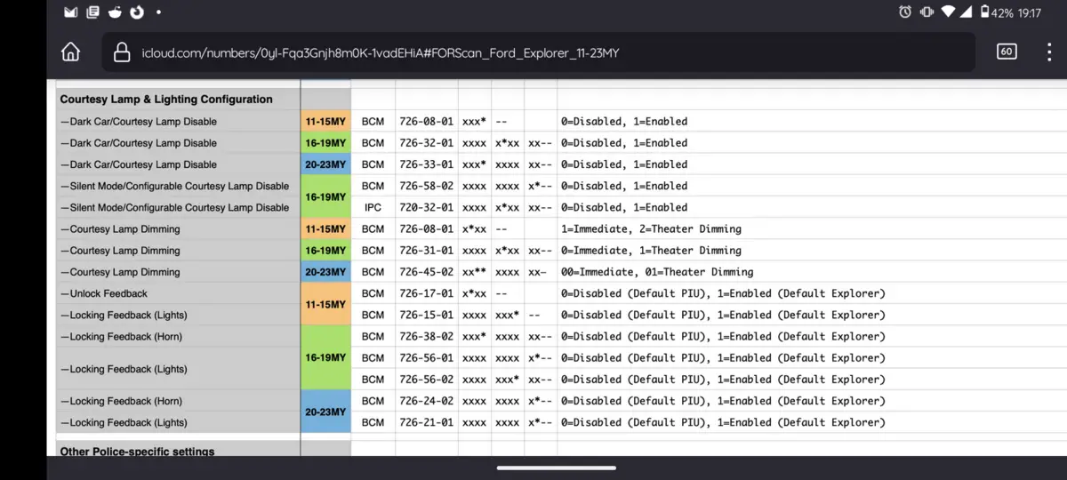

It doesn't look like it wants to accept it. I was messing around in AS Built in that spreadsheet. I did unlock the "Locks" and "Power Liftgate" but is grayed out. I do have trouble codes created for invalid info for rear. But it dosesnt trip a code on the dash.
Yeah, sounds like that ment option isn't in the firmware for your model year. After changing it in the BCM, the interior lights should work. I'm still thinking it's going to be a physical wire disconnect somewhere.

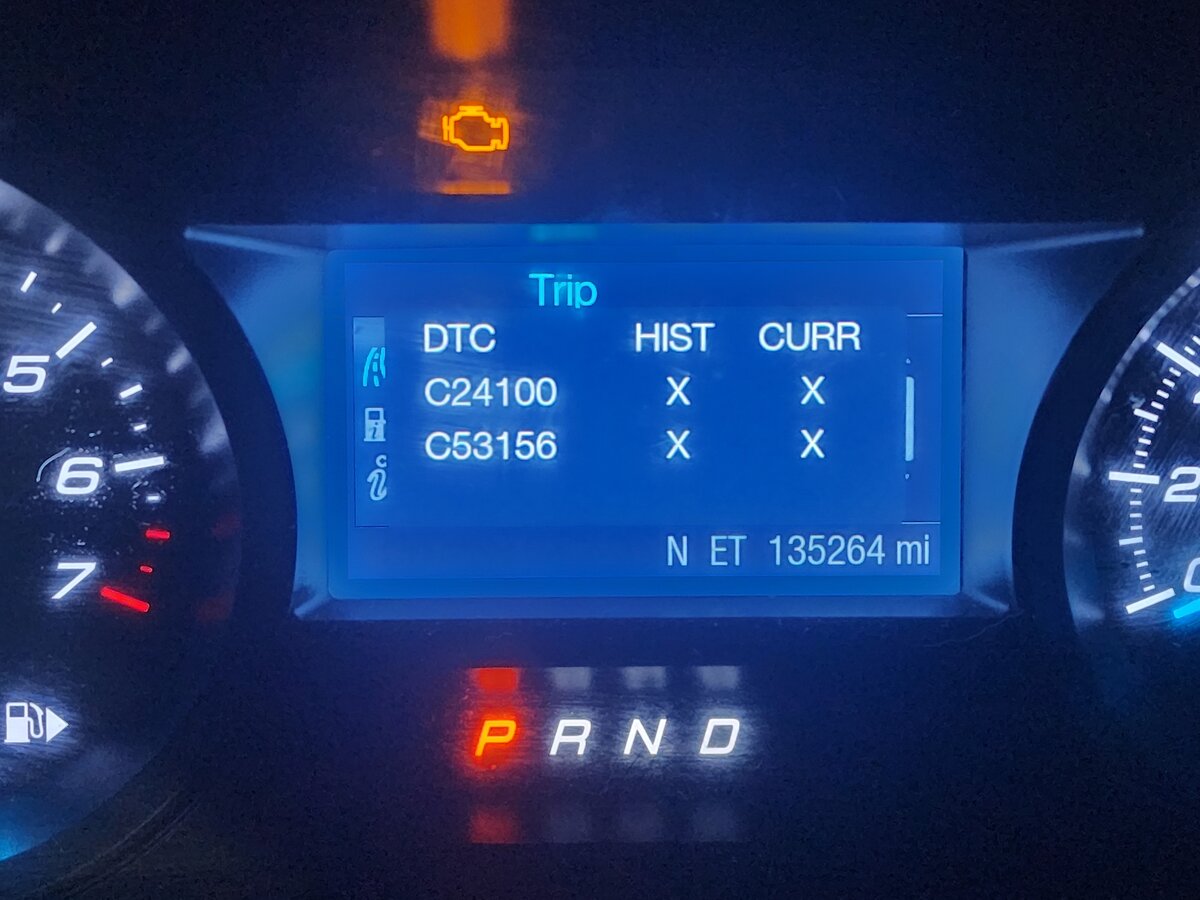

Yeah these are the trouble codes I have. No check engine light or anything. I can't figure out what they are for. Someone that owns a Police Interceptor Utility managed to get it to appear, the remote start menu. They have a 2014.
I'm not fimilar with C trouble codes. All the ones I know start with P. Might need to ask Ford on that one.
C trouble codes are chassis trouble codes. I'm not sure what those codes mean, I can't seem to find anything on them.
Did you enable some things in Forscan that you don't have the hardware for, so it's throwing a trouble code because it can't find a device it's looking for?
I enabled something and it enabled auto locks and auto liftgate but the liftgate is grayed out. I'll have to restore my backup, doesn't effect performance or anything.

Also, it looks like your model won't accept the menu setting. Try changing it opposite to what it is in the BCM now and see if that fixes it.
Sorry for the confusion.
I've disabled pretty anything police related on the car and enabled most of the civilian stuff. I can't seem to figure out the lights.
