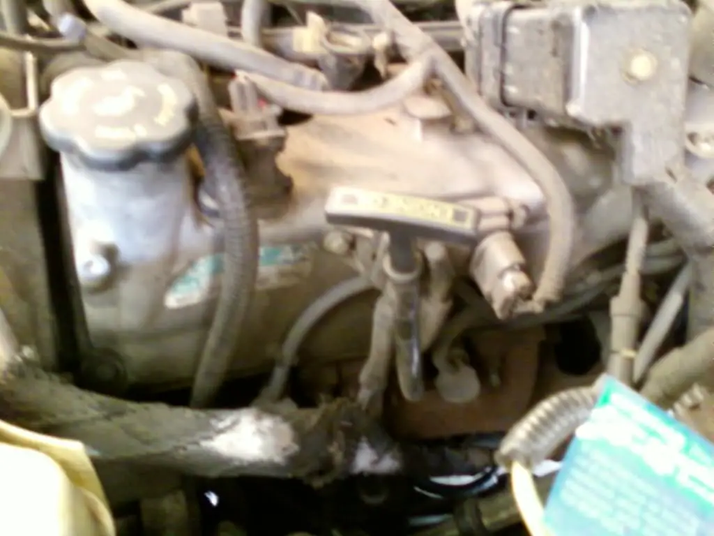

So..after nearly taking the engine fully apart the verdict is the drivers side cam chain tensioner was the only problem I had. The engine had been into before and i'm guessing all the plastic tendsioners and guides had already been replaced. I was expecting the worst because of the noise it was making and the things I had seen..so here it is.
The beginning of it all..throttle body has to come off..well, it makes it a whole lot easier anyway.
