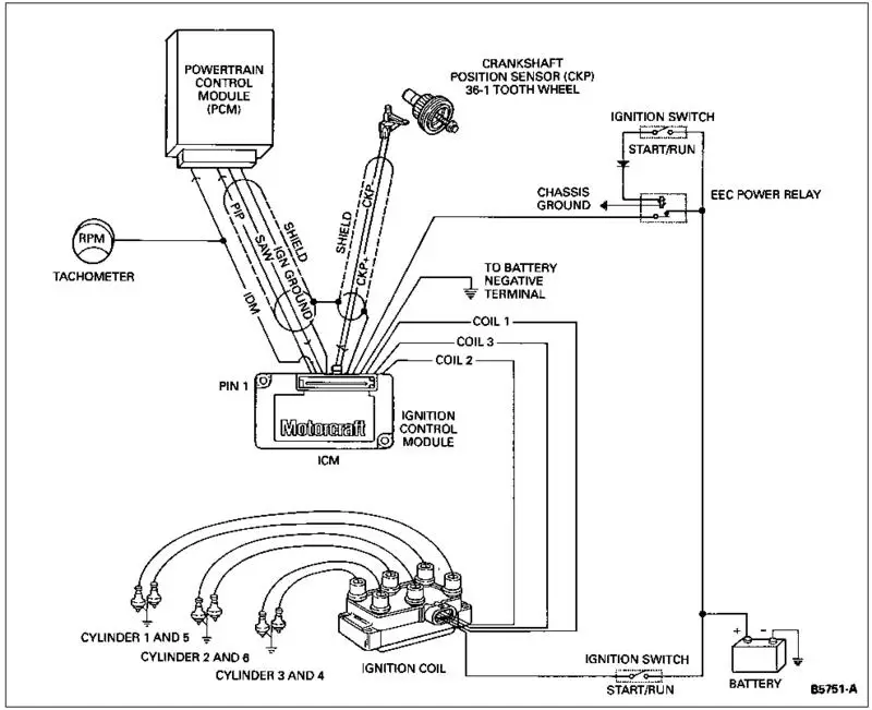

I have a 1993 Ford Explorer with the 4.0 that I have a problem with the rpm's gauge falling and cylinders cutting out when they drop. I have been trying to figure this out and for a few months now and the only thing I can think of is the ecu is crapping out but I wanted to check all other possible problem before I drop $100 on something and it doesn't help.
