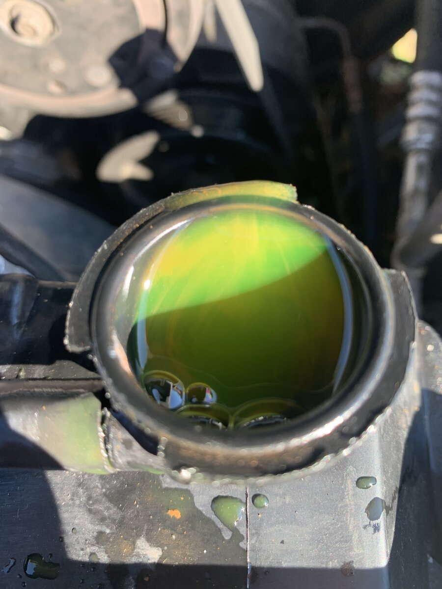

Had firestone flush the system and now I’ve got that hot hot heat.
Tried the hill trick first and got some soda bubbles out but no burps. Had room temp heat blowing out.
System need a flush anyways with all the new goodies. You can see there was still rust or whatever all in the system
