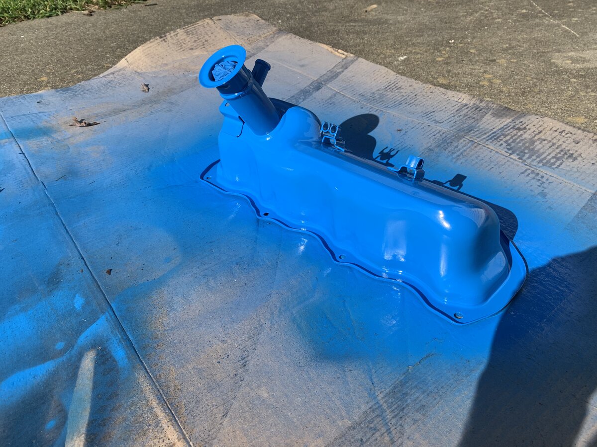

cleaned the engine bay to make reinstall easier

Glad you painted. Just wanted to save you from dealing with this, or some random junkyards down the road

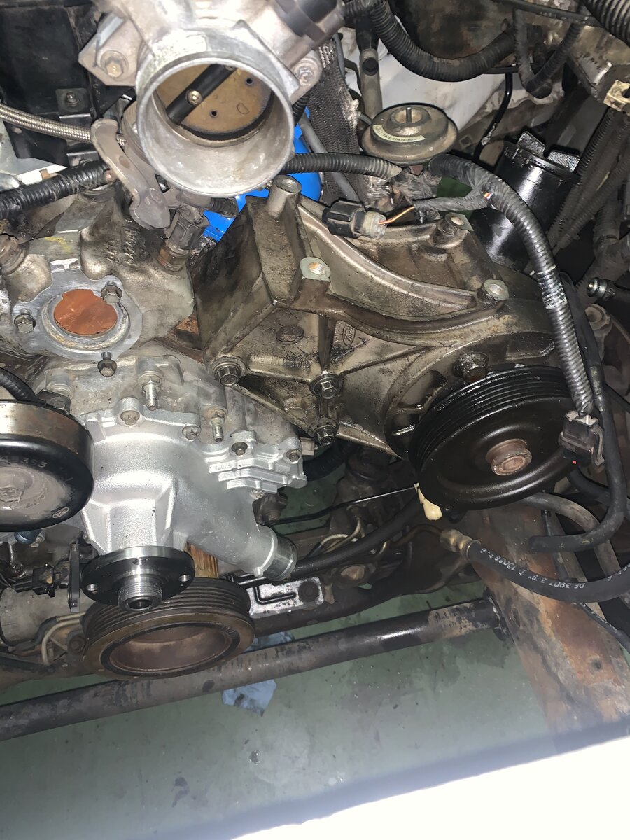

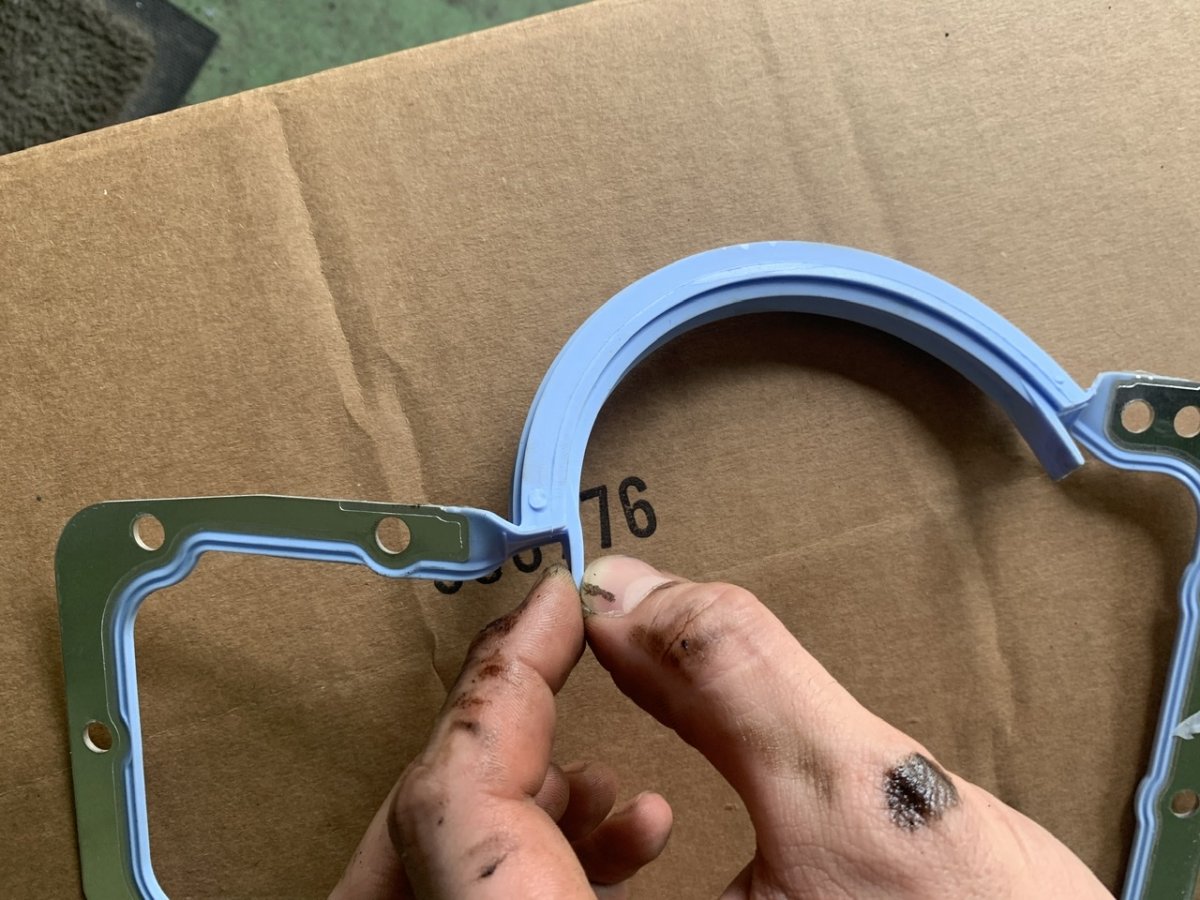

I’m trying to replace the oil pan gasket. Forum search is down...how do I get the ears off the old gasket around the backend of the crank
Here’s a pic

with a pick like a dental tool
You gotta get in there and get ALL OF THE OLD material out You can scrape it clean with small screwdrivers a small pick, etc
Use compressed air or carb cleaner to remove the little bits
When you get all of the old stuff out the new gaskets will fit down in there perfectly
I use permatex at all spots where gaskets meet and in all corners, also wherever there is a small gap like where heads meet block, timing cover meets block and pan, etc...........
Thanks! Wow what a pain. The engine will be fine upside down for a few hours yea? It’s dry but back together cept for the oil pan.
yes it can sit like that for however long you need it to, not going to hurt anything

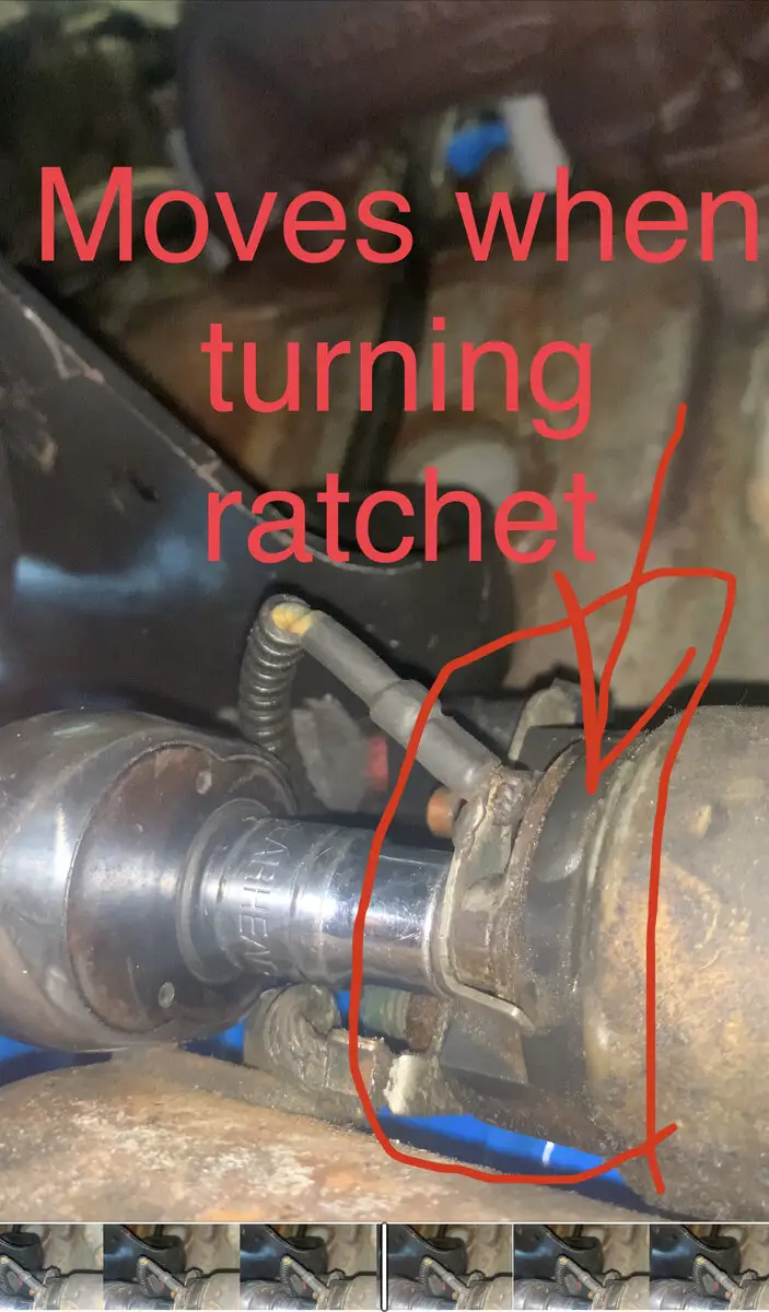

the starter can only be wired one way but while I was checking it I noticed it seems like the solenoid ‘cap’ wiggles when I’m tightening the bolts. Maybe bad starter?

If you are sure about all the other wiring, I would start to suspect a 20yo starter. You can overhaul them but probably a parts store starter will do. Sometimes cables rot internally, and you can't see it visibly. You have to do voltage drop tests to be 100% sure.
The play don't look good though. It is something that can leave you stranded down the road, even if it does start to work.

I’m about to pull the starter off and look at it.

Pulled the starter off and cleaned mounting surface. Bench tested the starter and it worked right. Put it back in and nothing.
