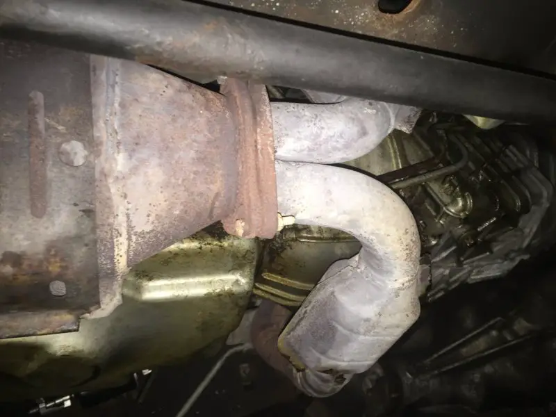

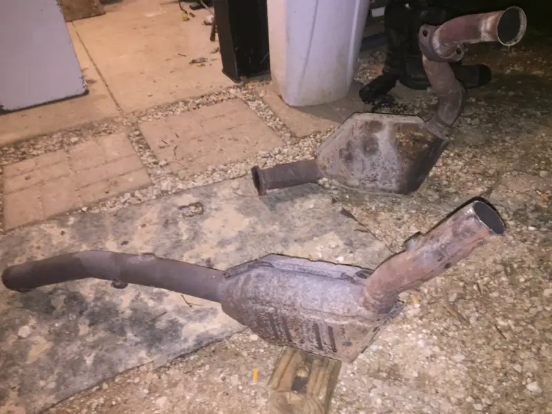

Hello everyone, I’m a new member to the forum. I have a 2000 Explorer XLT ohv 4.0 . I have 1 week left to renew my plates and I’ve currently got gutless cats . I went and bought two off of a 98 yesterday but the system was different from mine. I had to purchase them because it’s the best option I’ve found in my price range . Has anyone fabricated or rigged there own custom setup that keeps the dreaded 420 codes clear? Any help or info is very appreciated!!

Those 2000 model down pipes can also be used but you are going to need a welder/fabricator (exhaust shop) anyways to chop up your 98 pipes and install the 2000 primary cats

The system you bought from uses a PCM that requires 4 oxygen sensors. Your 2000 system uses 3 oxygen sensors, which your PCM must match. Even if you could physically attach the '98 exhaust parts and plugged one of the downstream oxygen sensor holes, your PCM would throw a code immediately because the open side would not change the stoichiometry of the fuel air mix on that side. You would need the PCM from the '98 to work the fuel system, and the chip key and antitheft system too. In other words, that was a bad purchase. If you can't weld the cats into your current system, you have nothing you can use. Sorry.

I doubt you will find anyone that will install used cat converters for you.......
