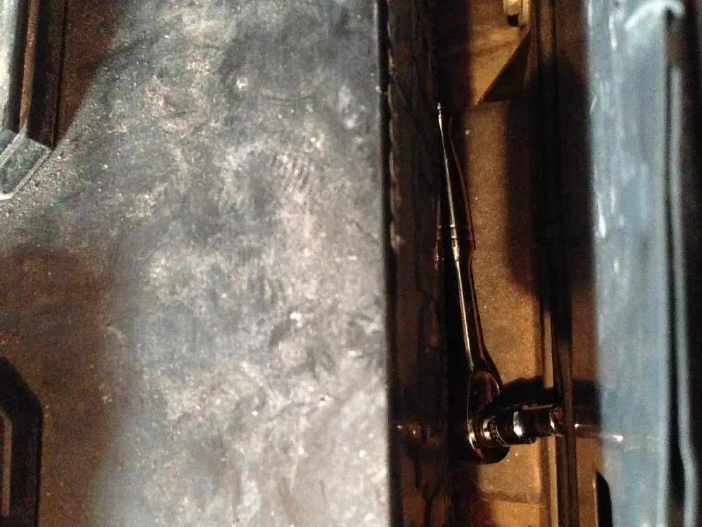

Lesson #6 - If your 1\4" ratchet is missing when you are finished, it might be behind your battery! It rode their for two days before I found it!

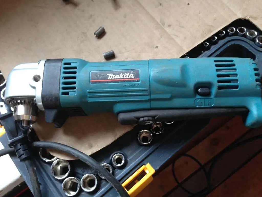

I went for the drill and extractor method. I was able to access two of them with a tight clearance drill but it was still too tight on the drivers side (behind strut tower). On another forum I found mention of this Makita drill.
This is an awesome unit for this job on our trucks. It was very low clearance plus it has a deep head for accepting bits. I was able to buy one locally for $300, not cheap but cheaper than it taking it somewhere to get it done. If you attempt this job and plan on drilling, buy, beg, borrow or steal to get one of these! If you are in the Saskatoon area, I have one for rent!

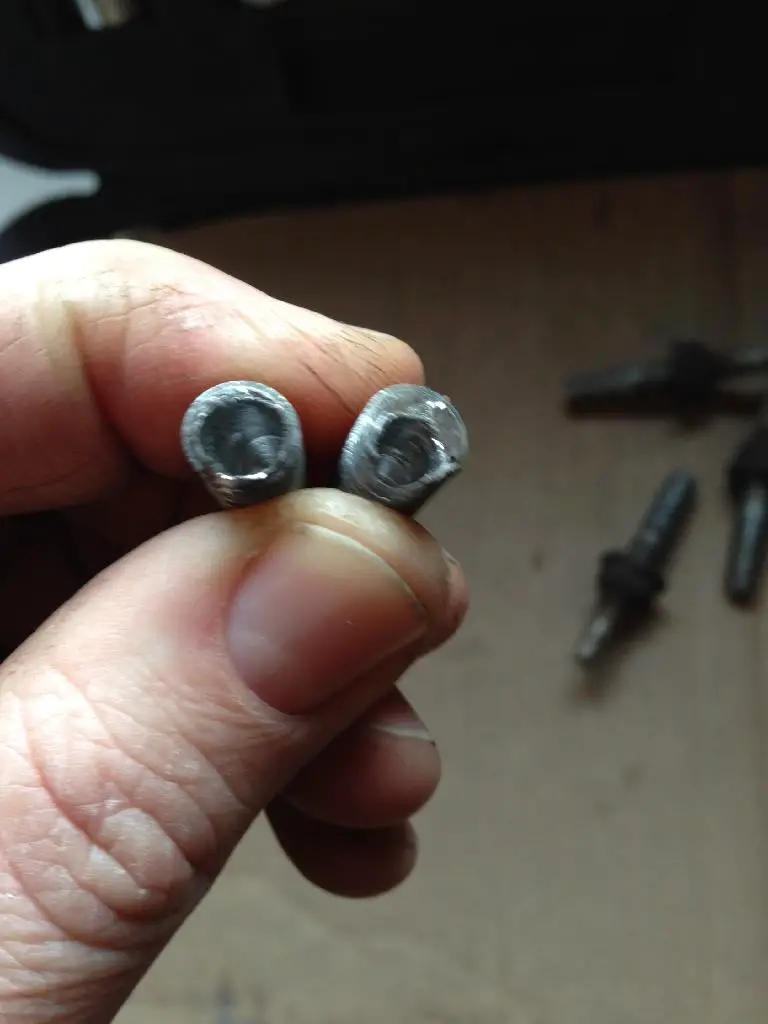

Now that I had the drill I picked up some LH drill bits. I did a pilot hole with a 3/32" bit and a final drill size of 5/32". I did not do anything fancy to center the bits. Just eyeballed a center and punched it the best I could. One stud I was really close to center and the other I was off, but was good enough.
I had bought a set of spiral extractors but could not get them to bite. I tried several things to get them to bite and they would just round off the flutes. That was when my dad (40 years of heavy duty experience) stopped in to see how it was going. He went home to get his experienced extractors. I took one of these and tapped it in.
I had those suckers out in a matter of minutes with a proper tool!

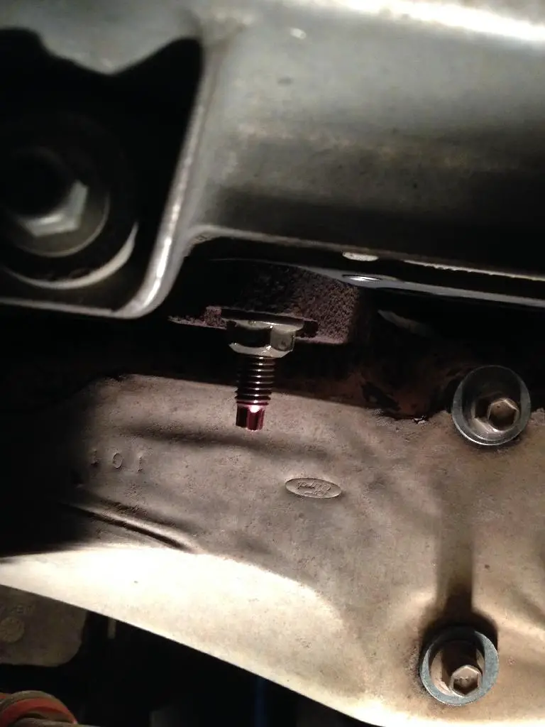

Installation was straight forward with installing the new studs, gaskets and nuts all from Ford. You can also see on my heat shield that I put washers under the bolts. The original heat shield pads had corroded.
