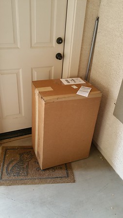

OK so here's the deal, I have it 85% done (FedEx "lost" it for a while and delayed my time to get it "mostly" installed")
The front mounts seem to the tough spot, could be the bottom hangs down just a little and could be trimmed with a Drimel tool or I just need more time to finish along with a LONGER socket extension. But it's in and really stable with the rear only secured.
Here ya go!
Unboxed:
Seats flipped (front all the way FWD to ensure most room)
Removed OEM cover
Initial test fit
Not much room to work
Cutting the carpet (scary on new vehicle)
Secured:
