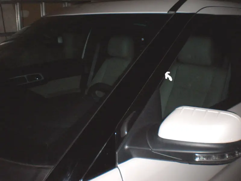

The next trip to the dealership will be to get the black decal replaced on the drivers door when the parts are in. They had to send a photo to Ford to get the OK to repair.
They did this on mine as well. 98% better than before. Just one or two small bubbles right next to the mirror on the passenger side. But much much better than before.
Would you mind expanding on this one? Not sure what this is?
Thanks
Thanks
I believe what Birdhunt1 is talking about is that black strip along the edge of the door that runs from the mirror to the top of the driver's side window (see that rather crude white arrow). That is actually plastic and some owners have had bubbling under it.
That is correct the decal on the drivers door has bubbles near the mirror. The tech told me that Ford is now requiring photos be sent in before they OK the repair. He said they now have to do it for the A-pillars also, but my parts had been ordered before the requirement came out. The a-pillar parts had been on back order ever since the TSP concerning them came out.
