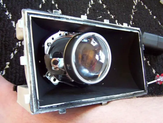

Sounds like a good idea. I had a hard enough time getting the back of the projectors to fit through the openings in the frame. I had to mount my ballasts in the frame. You might be able to see how the projector barely fits in the opening in the frame:
Tight Fit

I got my X5 headlights with projectors.. do you happen to have any pictures of the bulb assembly and how they actually attach to the projector? I'm having a hard time picturing it in my head.
You can see his pics here
Thanks for the pic Husky... but what I really meant was, how the actual bulb goes into the back of the projector, how it attaches.. and how the ballast and ignitor attach as well. I have a hard time picturing how the bulb is held in the back of the projector.
And then the plug for the ignitor/ballast just pops right onto the back of the bulb? Does it stay there on it's own, or is there supposed to be some sort of clip that keeps it connected to the bulb?
Yep. The ignitor has a special lock.
