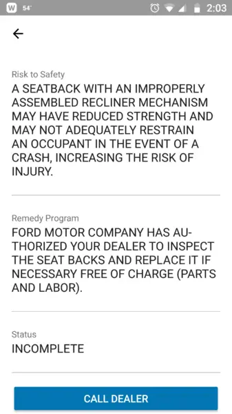

Received my first official recall letter from Ford today. Dated October 2019, Compliance Recall Notice 19C07 NHTSA Recall 19V-633. Issue, one or more of the seatbacks may have an improperly assembled recliner mechanism. Time needed, less than one-half day. Build date was last of August, received on Sept 3.

I took care of this recall today, or at least I think so. After about an hour the service said I was good to go. Paperwork only showed recall 19c07, inspect seat recliner, warranty. I asked if the seatback passed the inspection and if any parts were replaced. The service rep looked on the computer and advied that it was inspected and a wiring harness was replaced. The description of repair seems to be different from what I had expected. Anyone else had the wiring harness replaced due to this recall inspection?
MECHANICAL SEAT RECLINER
NHTSA Recall Number:
19V633 NHTSA Date:AUG 28, 2019 Ford Recall number: 19C07
Recall Description:MECHANICAL SEAT RECLINER
Risk to Safety:A SEATBACK WITH AN IMPROPERLY ASSEMBLED RECLINER MECHANISM MAY HAVE REDUCED STRENGTH AND MAY NOT ADEQUATELY RESTRAIN AN OCCUPANT IN THE EVENT OF A CRASH, INCREASING THE RISK OF INJURY.
Remedy Program: FORD MOTOR COMPANY HAS AUTHORIZED YOUR DEALER TO INSPECT THE SEAT BACKS AND REPLACE IT IF NECESSARY FREE OF CHARGE (PARTS AND LABOR).

Thanks Peter, the only recall on my VIN was the 19c07 seatback recall inspection. Why would they report that it was inspected and the wiring harness was replaced? Just wanted to know if anyone else had a wiring harness replacement with recall 19c07 "improperly assembled recliner mechanism". I am thinking the entry for a wiring harness was in error or the service rep was looking at a different vehicle. I don't see how the wiring harness is related to the seatback inspection.

Mine fell into this recall and can tell you that the work order when I got a copy of the paperwork had the notes from the tech and how much pressure the seat tested to using the tool Ford requires them to use.
blwnsmoke, thank you, that helped me find the repair information for the recall: Not likely that they did the correct inspection as I observed the tech setting in the second row and working somewhere at the bottom of the driver seatback. The 2020 Explorer recall is for the second row seatback if I am reading this correctly. My third row was down so they could not have inspected the second row seatbacks. The recall appears to be for the manual recliner seats only and for the 2020 Explorer only the second row rear seats.

Correct, it is the back of the 2nd row. If they didn't test them, they did it completely wrong.
