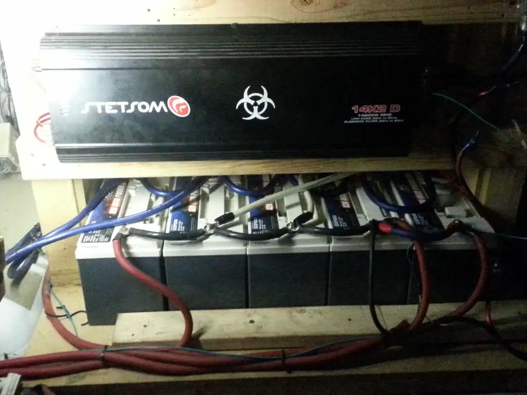

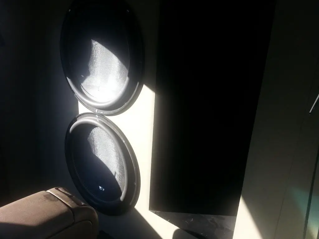

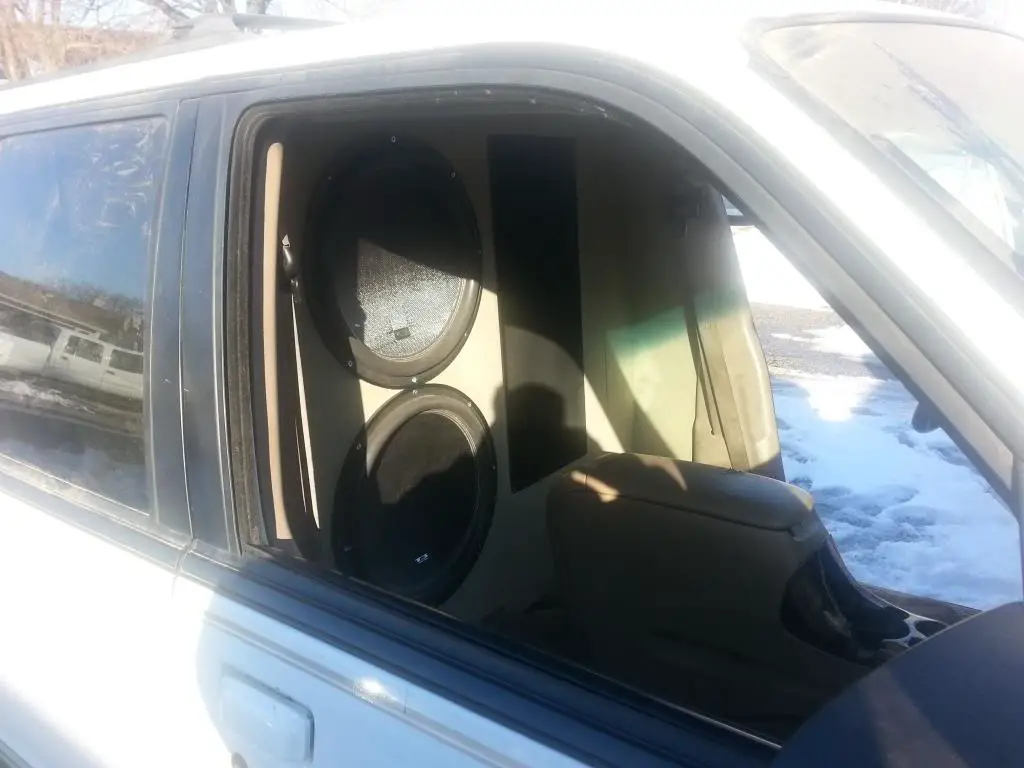

Damn nice system by the way. I'm a huge bass head as well. What kind of subs are those?
those are very rare beast subs 2010 modle tsns 18s by t3 audio.they aint no joke lol.
GOOD GOD MAN!!!
I wrote it in all CAPS so you could hear it... LOL.
Bass Head here too but I was not expecting this to be a CompTruck!

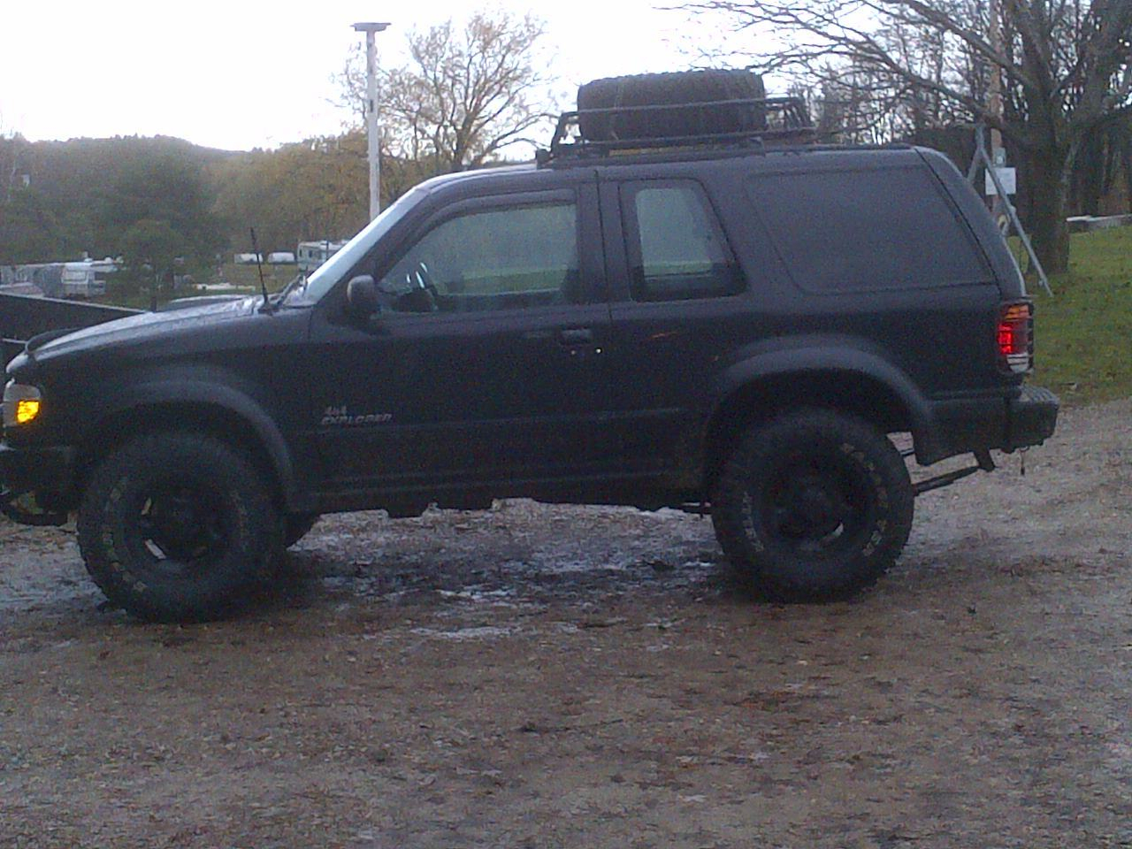

Here is exactly what I am ordering next week to compliment the Monroe Sensa-Trac Load Adjusting Shock Absorbers that will be installed tomorrow.
After that, a new sway bar and I'll be set.
The leaf packs are not sold in pairs and I think it was around $277 shipped, but for 1,250 pound load capacity just for the pack itself, that's not so bad.
They also have a "Helper Spring" they call a Super Spring that will surely give you that final push of stock ride height with all that equipment in the back.
Yes its a comp truck but I do drive daily.loudest so far is a 157.4db lol.first two shows are around corner april 7th will be at sudden impact in alsip il.2nd april 14th radio doctor madison wi.
157.4 is no joke!
I've never hit that ~130's
Trying not to wreck my ear I had surgery on because of this sport lol

This is just the Front Monroe SensaTrac Shocks installed:
This is front Monroes and rear Monroe SensaTrac Load Adjusting Shocks
Thinking about turning my Torsion Bars a little to level it out.
Other than that, I have to hook up to our 15' long car hauler to make this thing sag anymore!:D:thumbsup:
