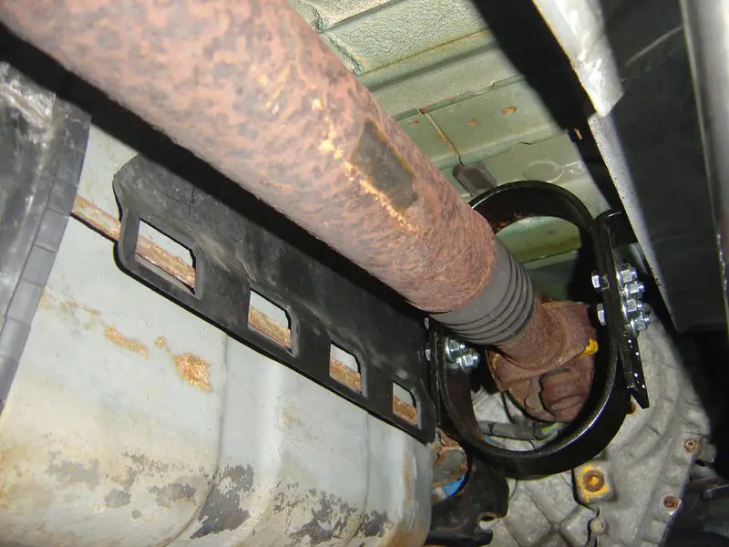

Driveshaft loop
I installed a driveshaft loop a while back, then I finally removed the fuel tank skid plate.
i will imagine you had to drop your tank to put that on, and bolted it to the top of the frame rails. also, how far back must it sit from the u joint and is that a universal loop?
