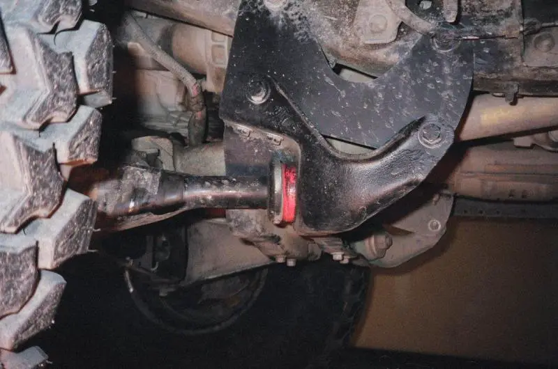

I have my Skyjacker 4" drop brackets I'd sale if you need them. PM if interested.
Here's a pic of them on the truck. They'll come with all the bolts and will install just like in the pic.
