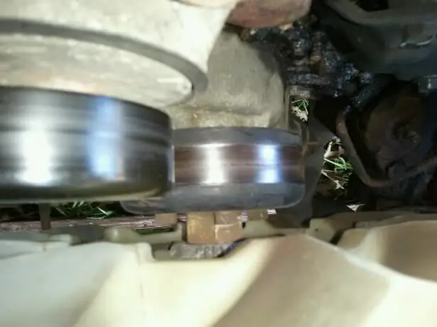

so while im doing my ac to non ac conversion i got to a point where i was fed up with it and went to do the fan... however my fan doesnt have those two nuts like the walk through showed... this is what my fan looks like
You actually do have the 2 nuts.. BUT, one doesn't look like a "nut".
Look at the 4 small bolts (10mm I think). Draw a line around the outside edge (around) the 4 bolts. That is the size of the nut. The really big wrench goes around all 4 of those bolts and those 4 bolts act like a single big nut.
~Mark
