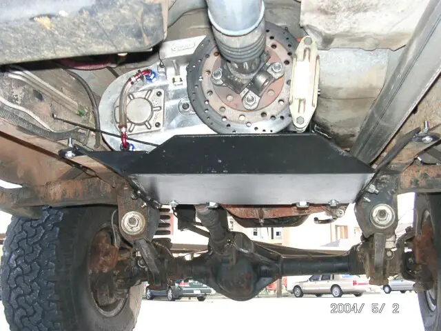

Here's some pictures of Randall's truck from yesterday.
The first one is of his new Atlas II transfercase with driveline parking brake and transmission mount and skidplate.

That Atlas looks a little low on fluid.... :D

Nice new pictures :thumbsup: How do you like the Atlas, and how does the brake work??
The atlas is great. It takes some getting used to, mostly because I've been crawling under the truck for the last year or so to engage the transfer case. The ebrake needs to be adjusted a bit, I don't think that it is quite grabbing right now.
