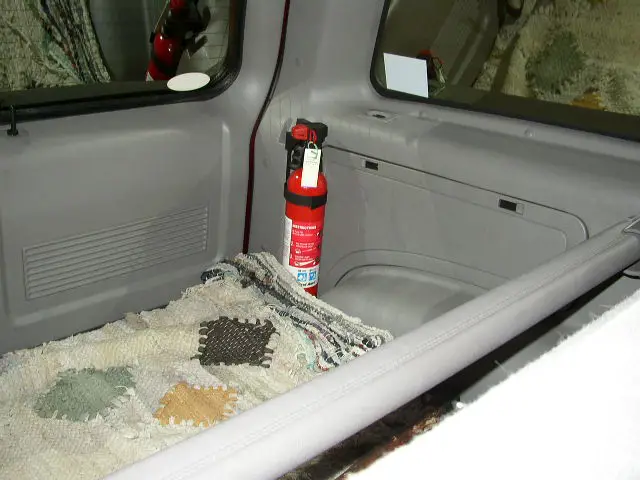

Mine is pictured below.
The mount is very sturdy. One of the mounting screws is into steel below the plastic panel just to be sure. Shaking the extinguisher shakes the truck, so I think it's secure enough. It hasn't moved at all in the 4 years I've had it mounted there; think about all the bumps and jolts it's taken in that time.

If you're going to do this mount it like Alec's and make sure the screws go into hard steel and not just the plastic. If you ever get in a frontal collision with the fire extinguisher mounted where most of you are talking, inertia will rip it right out of the mount and it will go straight through your head like a cannonball.
Alec says his has one screw going into the frame, and I'm not too confident that is enough either. The inertial energy stored in a heavy object like that is enormous if you hit a sudden stop at speed.
Just something to think about.
I agree Gerald, one has to make sure the mount is secure.
Whacking my mount with a 3 pound sledge didn't move it at all.
