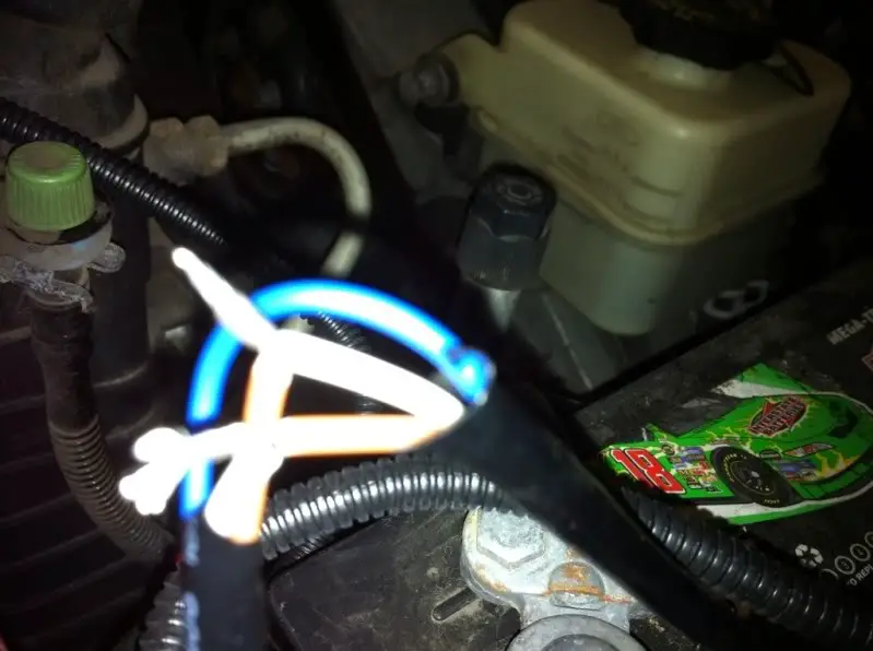

you are a god. I didn't know how to repin it so I just cut and used a soldering iron on the wires. Works great now. Thanks for the help everyone!!!
repinning it is a huge pain in the ass lol glad you were able to make it work :D
