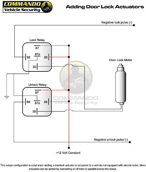

The keyfobs are turned off with ignition. There's no need for any extra module when you put in an aftermarket remote starter or alarm with lock/unlock outputs. You just hook them up to the power locks/unlock wires. Some older vehicles you need to five wire cause the module is in the door. Put that's still not hard.
It's also called reversing polarity door locks and it's done with two relays and a few jumper wires between them.
