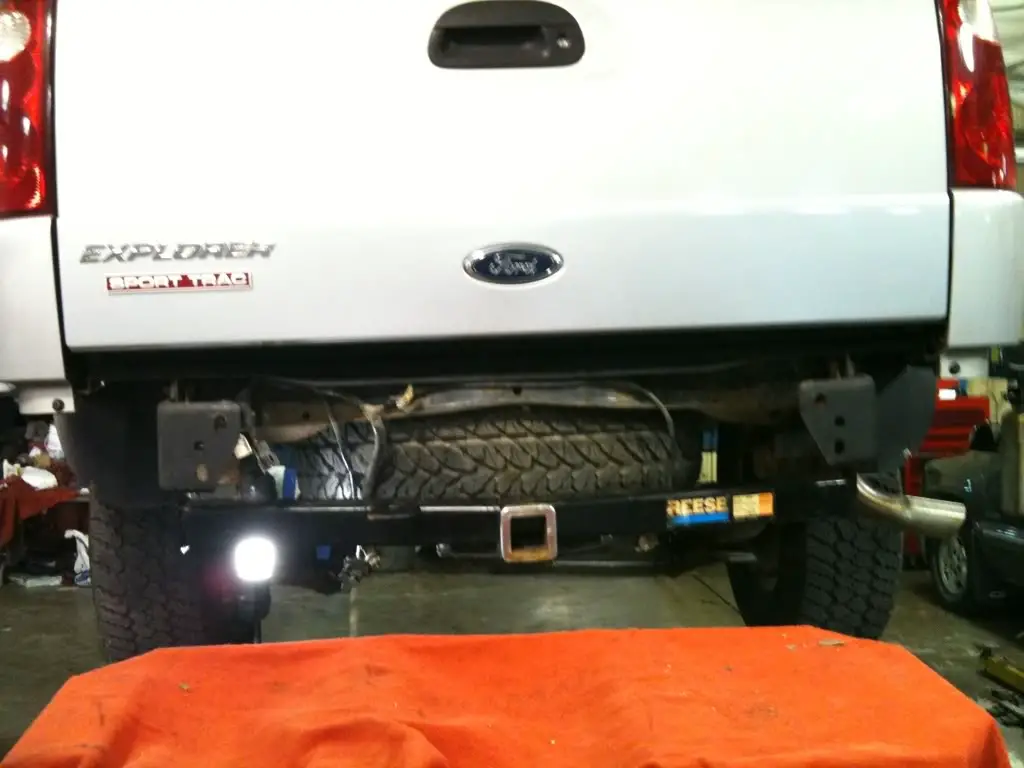

I just got a hitch on my 01 Sport Trac... And it was harder than it should have been!
First off, my grandpa is in charge of all the county roads, so his 98' EB Explorer was pretty filthy all the time. He just recently bout a 2010 EB and when trading n his old one, said I could have the hitch. I checked to see if my frame had the holes for it, and it did. The hitch was rusty and beat up, but still had the Reese sticker on it and all! Inspect some time with a wire wheel and knock all the rust and old paint off, smoothed it out, primed, and put 3 coats of semi-gloss on it and it's looking pretty good.

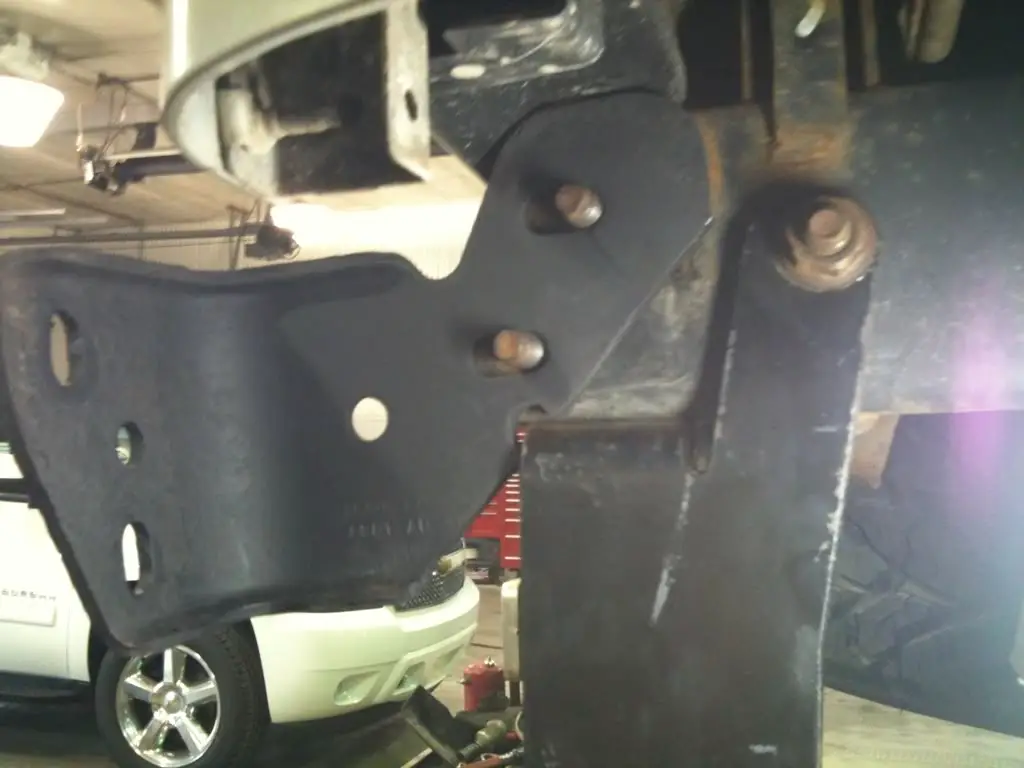

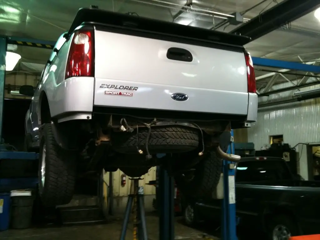

I then took my truck into the local GM dealership I did some work for and used the lift there and had some help from a friend who was a mechanic there. Upon close inspection the hitch would fit, but not easily. The bumper brackets on the ST were bent on the top and bottom for strength. This 1/4" of extra metal kept the hitch from mounting! So we took the bumper off:
Did some modifications to the brackets with the good ol' plasma cutter:
Bolted the hitch on (had to lower th spare, stretch the hitch, then put the spare back up)
Then re-attatched the bumper and cut the old built in bumper hitch so the receiver could be used:
Now all that's left is filing the plastic trim away about 1/4" to clear the recover completely! So instead of buying a hitch, I turned lemons into lemonade and scored a free hitch :p
