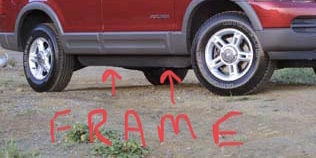

Hello everyone, I have a question that I have searched and searched for and have yet to find the answer to. Does anyone know what this trim piece is called that went in place of the running boards to cover the frame on the XLS models? I really like the look of no running boards and I HATE the plastic ones that come on them stock because they don't have an open back and just collect snow. The explorer in that pic has the trim piece I am talking about right under the driver and passenger side doors.
I have looked all over and can't figure out what they are called or where to buy them. Thanks for any help.

The plastic on the doors is part of the lower body trim, and does not extend much below the rocker panels, nor does it cover the frame. I can clearly see the frame in that picture.
This is about frame rail covers when not using running boards.

I drug the pic onto desktop then blew it up. Looks like it covers the frame rails well?
The lower body trim is attached to the lower part of the body, and doesn’t really extend below the body line. It is not a ‘frame rail cover’. On my XLS, there is a plastic strip about 1-1/2 wide that is mounted to the bottom of the rocker panels. Is that what you are referring to?
Either way, neither really covers the frame.
Nope. If you blow up the pic of the red explorer, you will see , below the gray door trim panel, A darker moulding trim , more inbound, that covers the frame rail when not using running boards.

Rocker moulding. Refer to my link or using inter web search, a few hits come up. When I find this in a Ford parts site, its usually under, Moulding, Pillars. There are two part numbers, left and right, xxx76 xxx77.
