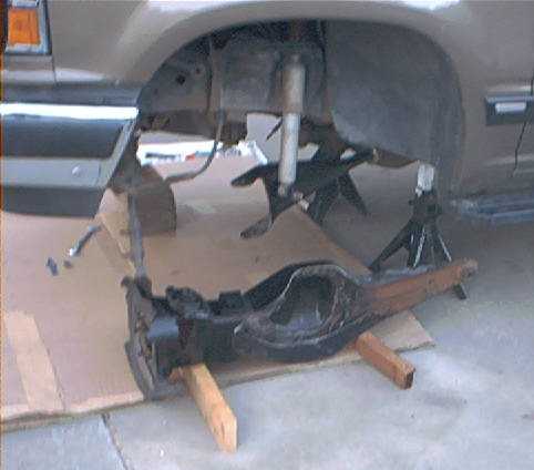

Ok I know this is an old thread, but reading it, I think I can handel taking my frot diff off and apart to clean it, its about my only choice its like a milkshake in there if not thicker.
