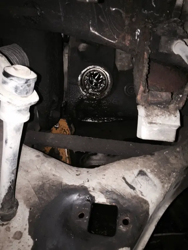

I am most likely certain that you looked but could it be the dust shield on the backside of the rotor? I had this happen right after I did my passenger side wheel bearing/hub and quickly found it and pulled it away (no more noise) just an idea.... But other wise yes it could be your wheel hub bearing and good luck to your search, I am in the middle of replacing my driver side suspension components now and found this which is I am pretty sure causing my front end whine:(
But I am going to get a replacement tomorrow and go from there..
