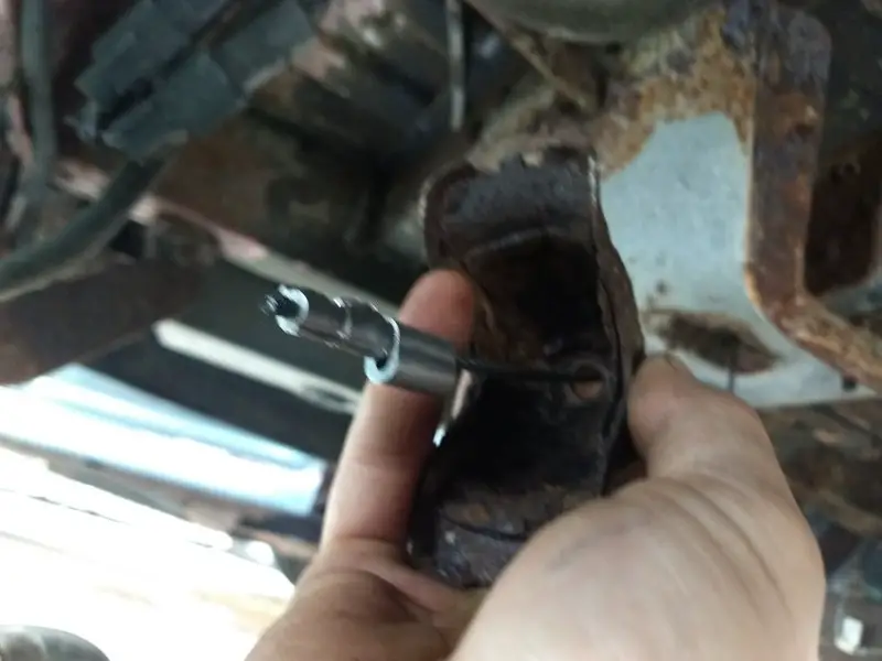

So courtesy of a nearby explorer, I used it's wrench to lower the tire from the van. What I found was not surprising but unnerving. The tire was hanging by a thread! I've been bouncing over Indianapolis roads the last couple weekends, to work on my sister's house and I can't believe the tire never fell out! Anyone who has driven in Indy knows what I mean. I will never complain about potholes around here ever again!
So, repair was needed. I found another used winch on eBay, but this one is in remarkably decent shape except the end. I used some garage door cable crimp ends to make a new stop for the bracket. It seems to be working well.

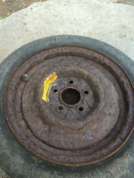

Some pics to show the ravages of rust in this area. The temp spare is completely useless. I don't think the lug nuts would even hold torque if it was to be used. I found a complete tire tool kit on ebay and ordered it. So at least I'll have something to use in case of a flat.
