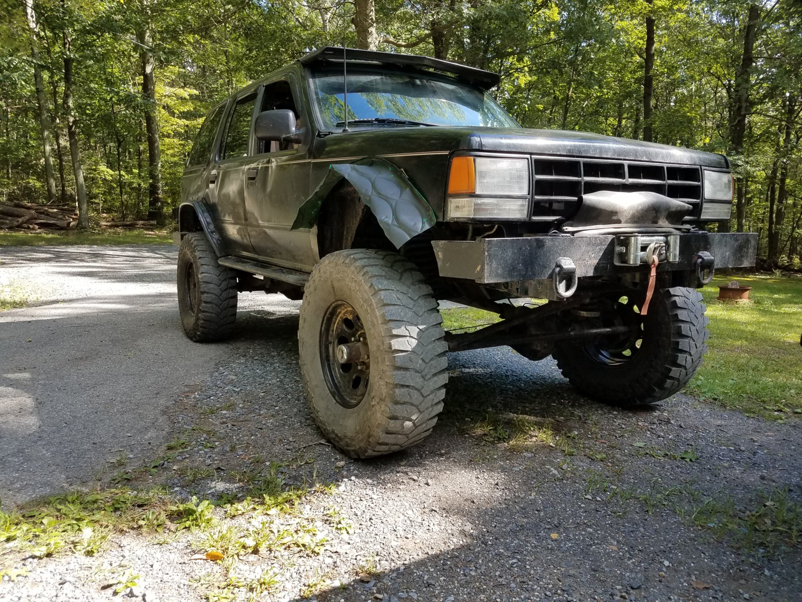

I run a fw 44 with Chromos and 35s. It seems pretty indestructible with my open diff. Ill add a locker someday. I built my exploder with a narrowed 44 setup with and ARB for years. I broke stock joints and lockers before chromes. I ran superjoints in my exploder, but I run Spicers in my current rig because I like to run it down the highway in the winter with the hubs locked in. I cut my cs off my 76 44 and moved them in about 2 3/8" on my current setup- then mounted my radius arms right up to the frame. I would do the same if I were you on that 75. No need to space buckets or radius arm mounts out that way. I also trimmed my drivers bucket to fit the frame bulge and welded/ bolted it on.
