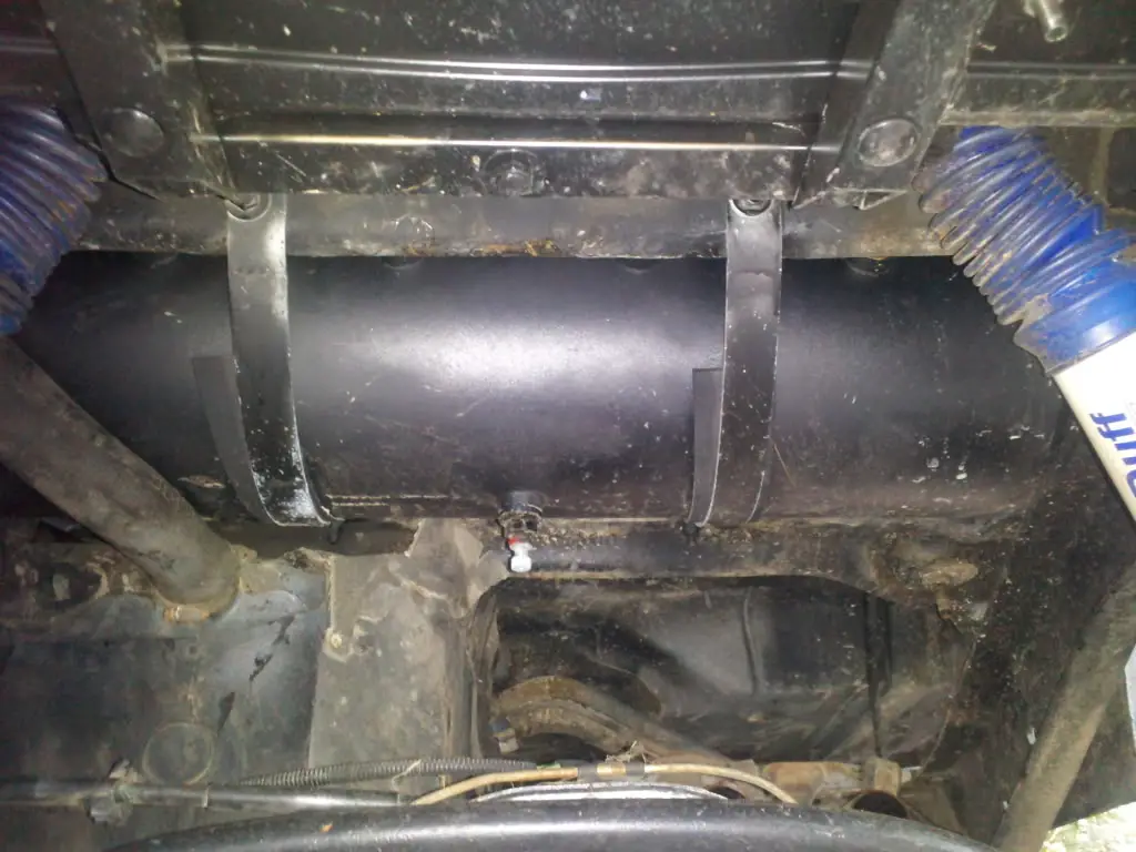

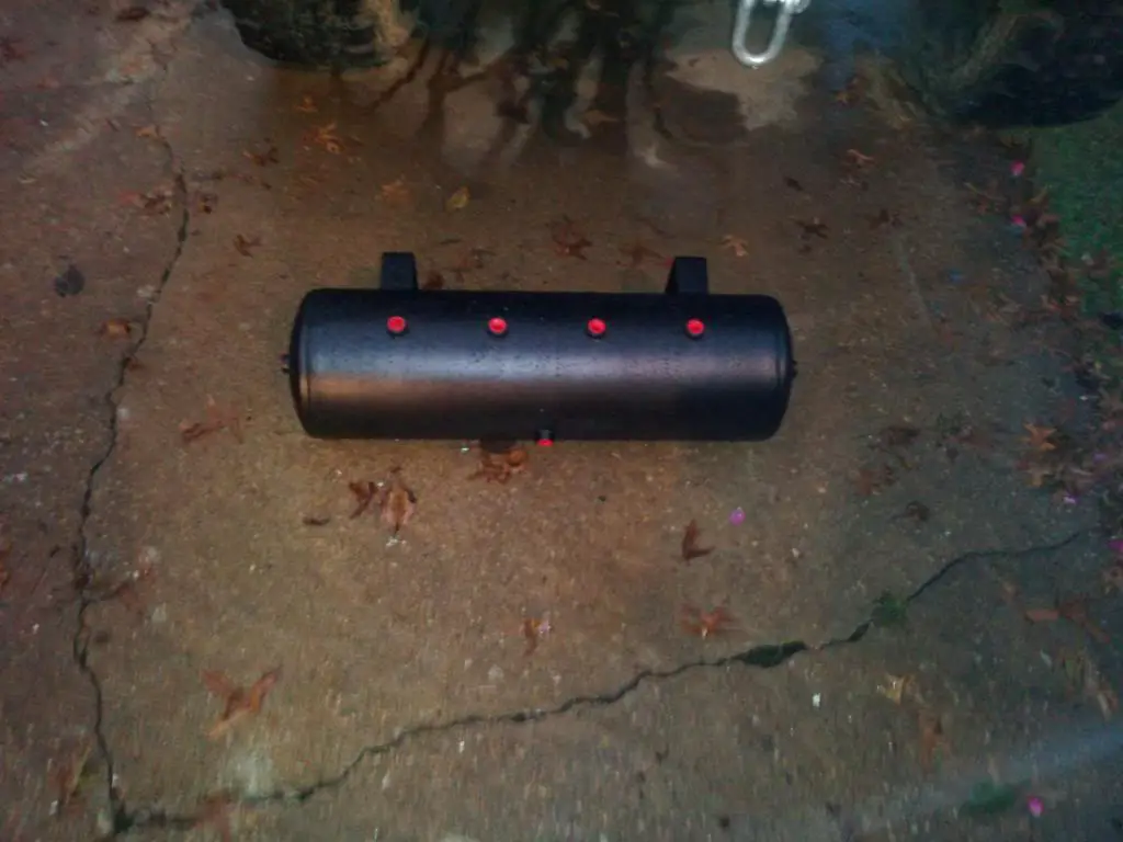

Here is what I did...one of my favorite mods;)I use this more than I can count.I still use the oil-less compressor but still plan to swap it to a larger oil ac unit..just so it runs cooler, shocked the oil-less hasnt burnt up.very cheap mod and endless usages
http://www.explorerforum.com/forums/showthread.php?t=333598

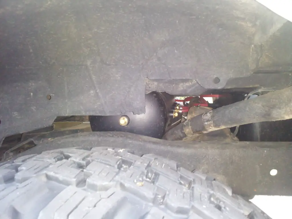

I have an electric pump and 2.5 gal viair tank. The tank is where the spare used to be. And the smitybilt dual pump is behind the rear quarter panel on the wheel well.
Id like to run a york eventually but the setup I have now works great. Aint broke don't fix it.

O yea I did see that..you could still mount the tank where I did and do a b2 swap.that is if you have a body lift..

Where I have mine mounted there is no real way you would ever hit it.you would destroy your gas tank and sooo many other things first.but to fit the larger 8.5 gallon your need a body lift, you can fit the smaller 6 gallon im pretty sure without body lift though.
I had mine under the passenger seat, using a 2&1/2 gallon tank. For inflating tires and such a tank isn't needed. Where the tank is needed is using air tools. The air tools need a big push of air to work. It was a fun and gratifying project that worked very well.
I used it to rescue my sister, she had a flat tire, inflated her tire on the PDQ! Used an impact wrench to remove tires and replace, and used a cut off wheel to remove buggered exhaust. The cut off tool was the worst for air consumption.
I like your positioning ! it looks good and has a nice big supply of air ! Congrats !
