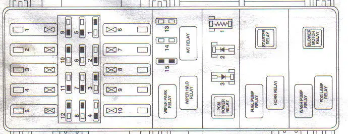

This is 98
There is also a relay for the rear wiper I think it is the washer pump relay, the fuse for it runs power windows also, fuse 12 10A, on interior fuse panel, and fuse 16 30A runs wiper hi low relay, wiper run park relay , and wiper motor.
this is underhood power panel, showing relays

The layout of relays and fuses are the same but i guess the numbers arent... according to my 2000 Manual it says that 8 utilizes a 15A to run the rear wiper motor. Thanks alot for that info I will see what I can do in the morning.
on the interior fuse panel , fuse # 8 is a 10A , and it protects rt headlamp, daytime running lamps and foglight relay,
in power dist box there are also 2 more fuses labeled # 8, 1 is a 20A maxi fuse and protects the auto ride control, the other is a 30A mini, protectsthe PCM relay
oh yeah? The #8 in the interior matches up with the 98 but the others do not... I guess its safe to say that they arent even close. Thanks again, hopefully my wiper woes are just because of a fuse.

This is 98
On my 98 there is a up relay and down relay for the rear wiper,located where the washer pump relay,and fog lamp relays are.
Rear wiper up being where the washer pump is and rear wiper down being where the fog lamp relay is.
