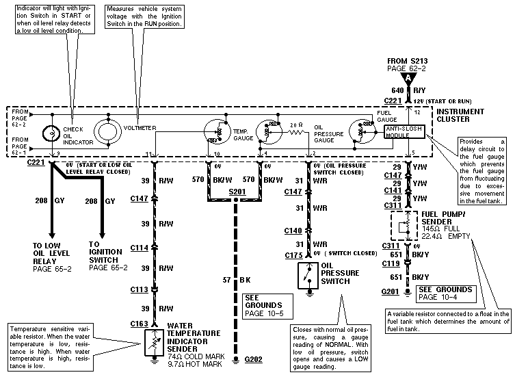

See the attachment.
What I read from this about the two gauges (correct me if I'm wrong).
Water temp gauge operates on resistance values from the sender, which is near the water neck. 74 ohms is listed as the approximate HOT mark reading and 9.7 ohms for cold. An internet search reveals this is common for many Ford coolant gauges. I suppose you could check gauge calibration by using resistors instead of the sender input.
I haven't yet found a specific chart for the sender but will keep looking. Don't confuse it with the Ford ECT sensor, which reports to the PCM and has a different set of values. Easy to find charts for the sensor, but not the sender.
Oil pressure is a switch, not a real sender, as is well known on the board. You can see it uses a 20 ohm resistor as the gauge signal. The gauge itself is capable of displaying a real range of movement but is wired up to only show on or off. It appears there is no wiring to indicate abnormally high oil pressure.
