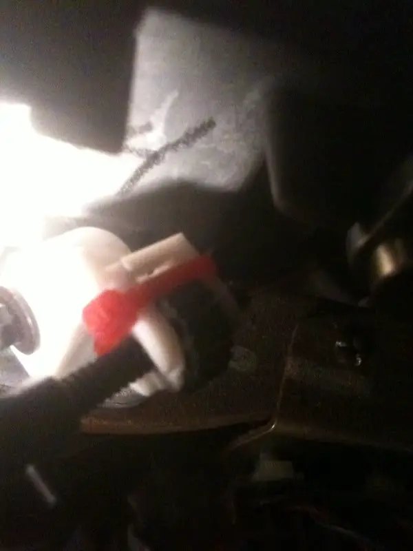

I found the wheel without having to take anything apart... unfortunatly, my white bracket was broken. I realized this meant i would have to take the panels off...

Once you can see the broken bracket, screw the thumb wheel counter clockwise until it's halfway between the end of the threaded part. this is where you can hold the wheel against the part of the white bracket that is still attached and see if your indicator is lined up again. You may need more or less depending...
Take the small ziptie and run it on the left (top) side of the cable. Take it easy with the copper cable, and make sure the ziptie is only squeezing the white pieces back together. Clip the excess ziptie off, and test your shifter!!
You should be able to reverse the process and put everything back together for a grand total time of around 10-15 mins.
