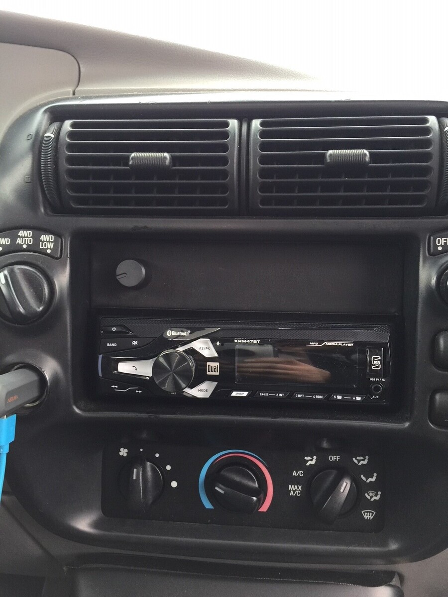

I pulled the factory head unit out and fabricated the single Din unit and cover plate above to fill the hole. I added a gain knob above the radio for quick control when I needed it.

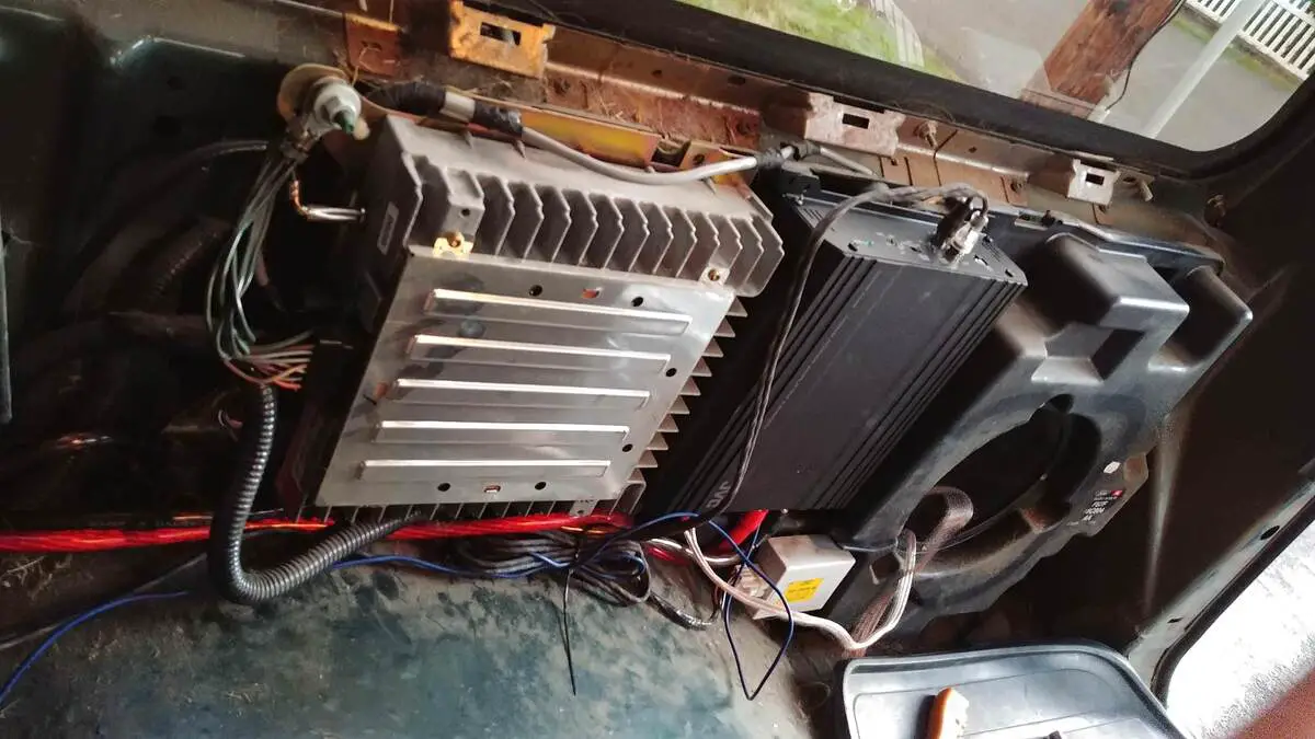

As for the Amp and crossover, I didn't want to screw them to the back of the rear seat so I fabricated an aluminum bracket to sit in the inset that would normally hold the speaker cover in place an put the amp/crossover over the amp hole. Needless to say, I still have access to all the space in the back and I can put my seat up and down with no issues.

Amps and crossover: I know the rca's are pinched on bottom of crossover - I have 90degree adapters on way to fix this issue.
Subwoofer behind amp:
