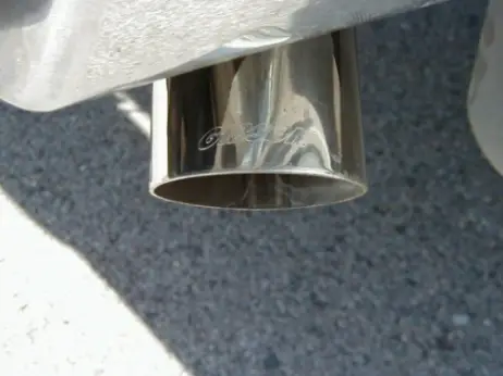

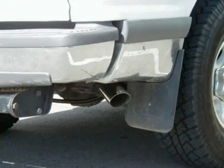

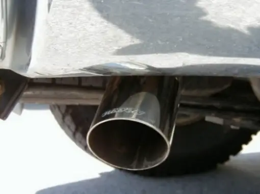

Here are the Pics. Enjoy!!
BTW After only a day mind you, I highly Suggest this Exhaust. I like it much more than what the old man has on his 99' (Flowmaster w/ custom bent aluminized)..Gibaon blows it away.
I can never post more than one at a time. Help!
Another
Last one...
Damnit!
