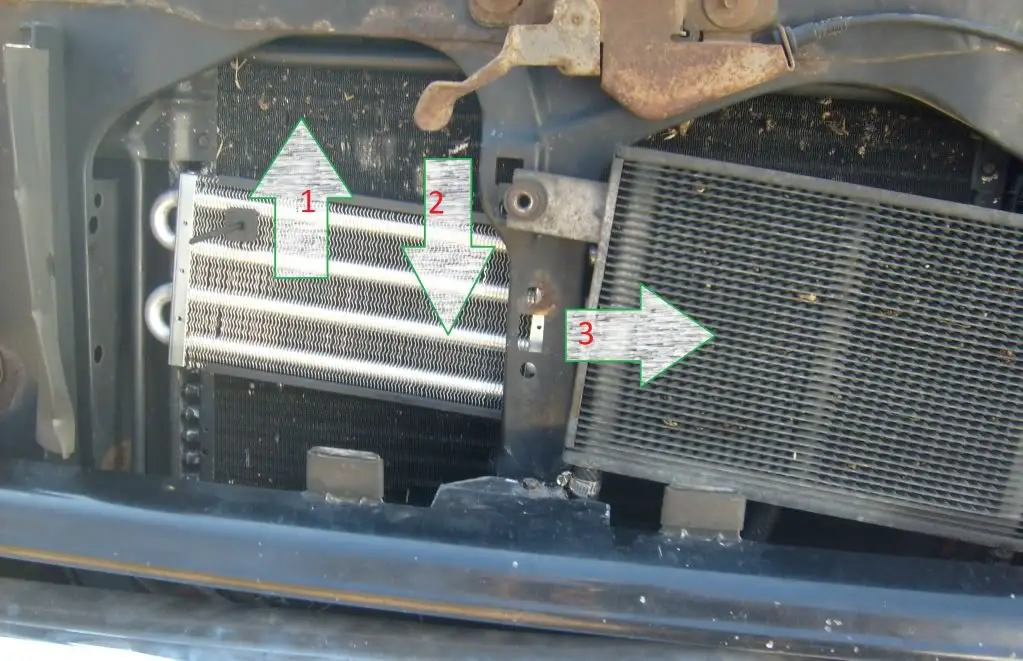

Thanks for the help. I see now that I will only start getting a reading once the transmission is warmed up. I never want to have to take that transmission pan off again, so I will just stick with the current configuration. At least I have an idea of how hot the transmission can get now. I had a hard time trying to find which cooler line was the return and which was the output. Until today:​

Yes, some did. My 99 SOHC V6 with the 5R55E has the factory aux tranny cooler.
External Cooler
So basiclly the transmission oil will pass through both radiator & external cooler then back to the transmission , or its just the external cooler & it has nothing to do with the main radiator ???
That's correct, the fluid passes through both the radiator and the aux cooler before heading back to the trans.
In front of the radiator, behind the grille.
This is where mine was, i no longer have the ex, but those i still have, ha, i need to get rid of them, but #2 was aftermarket, it was the final cooler before tranny.
