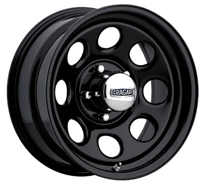

...These are inexpensive, $39.95 @...Cragar soft 8...;)
http://store.summitracing.com/partd...-3975812&N=700+400292+306459+115&autoview=sku

paint yours black? much cheaper. almost same look. unless your goin with a wider wheel or a bigger wheel it should work just fine

I've been looking at those Cragers and the price sounds good to me. My question is what would be better for street/trail use. I'm looking at the 33x12.5 BFG AT for the tire. Whould a 15x8 or 15x10 wheel be better?
Or does it not make that big of a difference?
8" looks better and you have much less of a chance of popping a bead. Check out the 33x10.50s too, they get down and dig and are $30 a tire cheaper, I love my 33x10.50 BFGs.

Also ordered the Cragar soft 8's from summit today.
