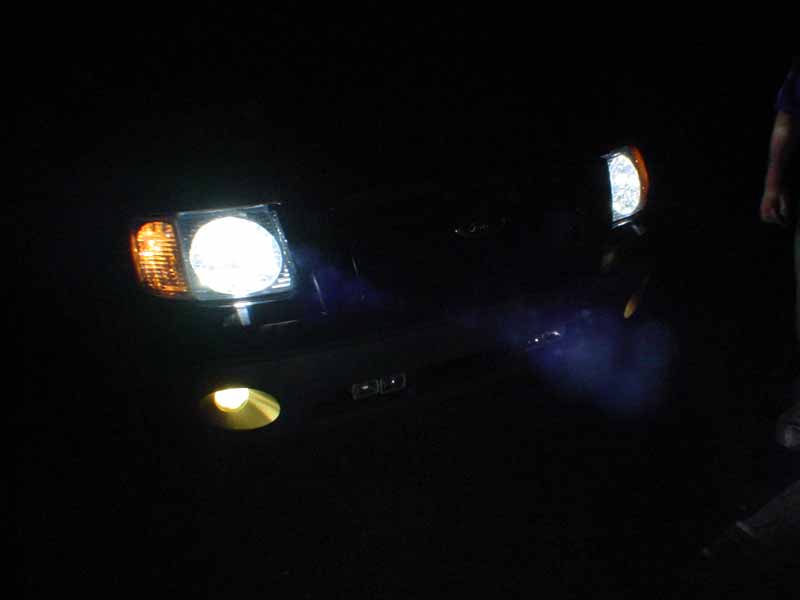

I have had my 5,800 true HID kit in my truck for over a year and have never had any problems from the lights. I have been pulled over a few times and nothing ever said about the HeadLights.
