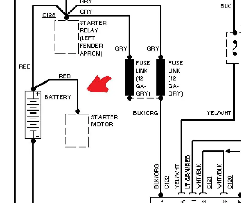

ok well here is an update
as of now alternator is good, wiring is good, and all fuses and relays are good
first i got a wiring diagram and then i did continuity testing on all the wiring related to the charging system and everything came up good but there is one wire im not sure where it ends... it comes off the batter and then goes down
any idea where exactly that wire goes to so i dont hafta go digging for it?
and if i leave the volt meter on the battery and start the explorer... the volts drop below 12v and then if i turn on other accessories then it drops more... which definatly means that the alternator isnt doing its job somehow
