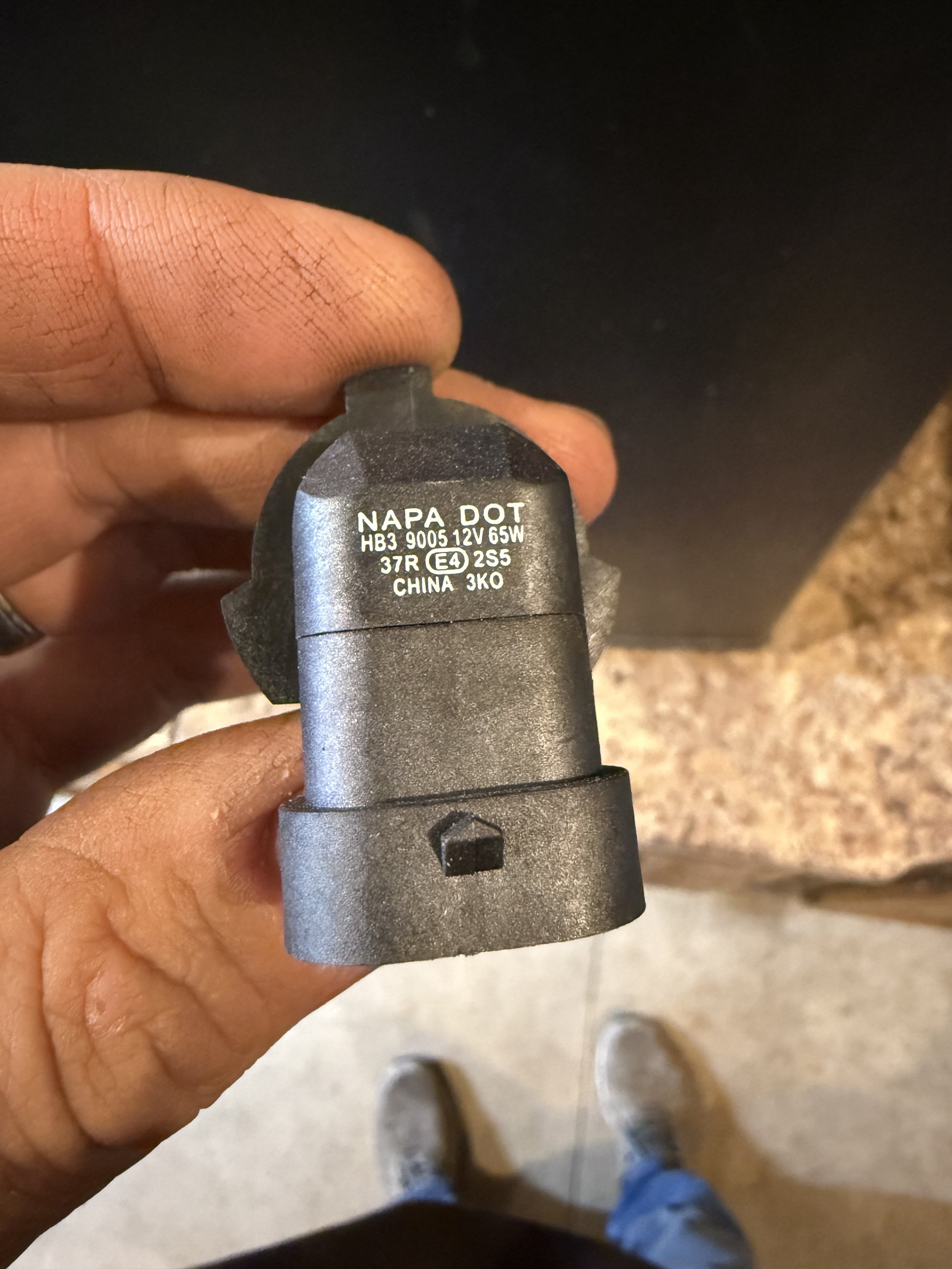

Multiple. Phillips, Sylvania, I think one was Napa’s house brand.
Well, that covers brand...
This was the most recent failure, a standard 9005 halogen.
This was the most recent failure...
And how exactly did it fail? Did the glass shatter? Did the filament break/burn/stretch? Did the terminals melt? How did the previous ones fail?

The filaments blow every time. Never the glass, the terminals in the pig tail are fine.

It’s my wife’s vehicle so I can only relay what I know or she’s told me. Pretty much every time they’ve worked when shut off, then dead next time she turns them on. Sometimes when starting the vehicle in the garage where you can see only one of them is shining on the wall, other times I’ve noticed it when she gets home and I see her pull in the driveway. We’ve owned the vehicle since March of ‘18 and to our knowledge it’s never had any collision. The bulbs seem to be snug into the housings, no, the housings don’t rattle, the pigtails have a nice click when plugging them in. The vehicle is bone stock.
Then I'd put GE bulbs in, and pay attention for next time.
