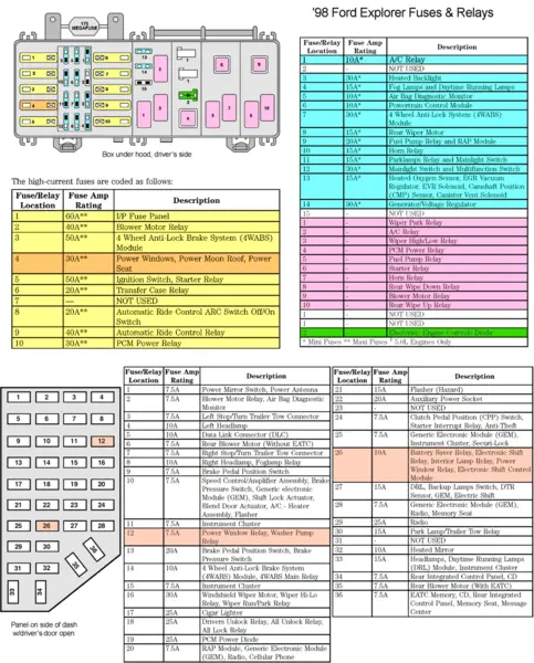

Yes check the fuse, and the park lamp relay next.
Quick question: where would the park lamp relay would be?
Driver floor board next to your right foot under the radio little black box
Thanks
