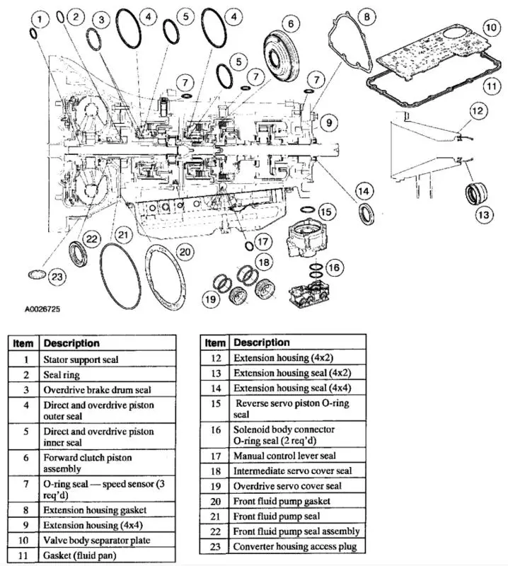

I was brought a 2002 4.0l 2 wd explorer automatic xlt that has a gurling sound at shifts. I pulled the drive shaft and can feel perpendicular play on the trans tail or output shaft.
I would like to know the bushing/bearing for this shaft is replaced by removing the tailshaft housing or through the case. Thanks in advance if you can advise me.
