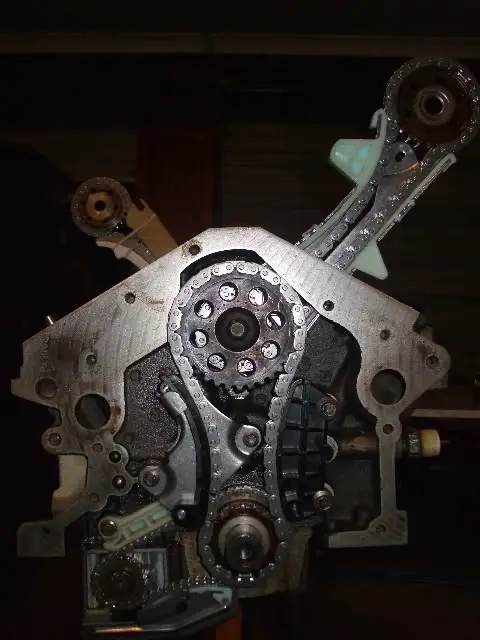

The following picture shows the location of all 4 timing chains installed into the engine block, without the heads of course. Please note: these are the upgraded timing chain cassettes with beefier springs and steel reinforcement. In your engine the rattle you speak of is cause by the upper right front timing chain cassette. On the original cassette there was a plastic guide that ran between the chain and had a habbit of snapping. I found peices of mine wedged between the lower Crankshaft to Jackshaft timing chain and the front timing cover.

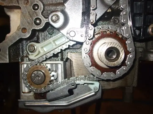

The following picture shows the Balanceshaft timing chain. Notice the metal tensioner spring under the plastic curved peice on the under side of the chain. This can become dislodged from its position if the plastic peice above it breaks. When this happens the spring becomes jammed between the bracket and the chain causing the "ticking" noise you can hear.

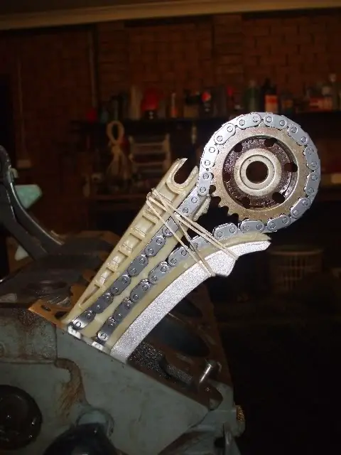

This is the updated rear timing chain cassette. For some reason they did not decide to reinforce the rear guide with steel.
